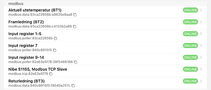

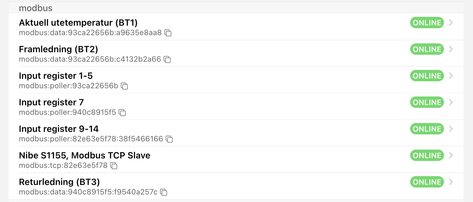

Three things to get this working to read current outdoor temperature (BT1) from my S1155:
UID: modbus:tcp:82e63e5f78
label: Nibe S1155, Modbus TCP Slave
thingTypeUID: modbus:tcp
configuration:
  rtuEncoded: false
  connectMaxTries: 1
  reconnectAfterMillis: 0
  timeBetweenTransactionsMillis: 60
  port: 502
  timeBetweenReconnectMillis: 0
  connectTimeoutMillis: 10000
  host: 192.168.1.252
  enableDiscovery: false
location: Main Building
UID: modbus:poller:93ca22656b
label: Input register 1-5
thingTypeUID: modbus:poller
configuration:
  length: 5
  start: 1
  refresh: 60000
  maxTries: 3
  cacheMillis: 50
  type: input
bridgeUID: modbus:tcp:82e63e5f78
UID: modbus:data:93ca22656b:a9635e8aa8
label: Aktuell utetemperatur (BT1)
thingTypeUID: modbus:data
configuration:
  readValueType: int16
  readTransform: default
  writeTransform: default
  readStart: "1"
  updateUnchangedValuesEveryMillis: 1000
  writeMultipleEvenWithSingleRegisterOrCoil: false
  writeMaxTries: 3
bridgeUID: modbus:poller:93ca22656b

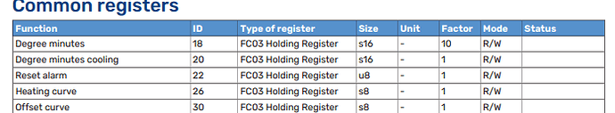

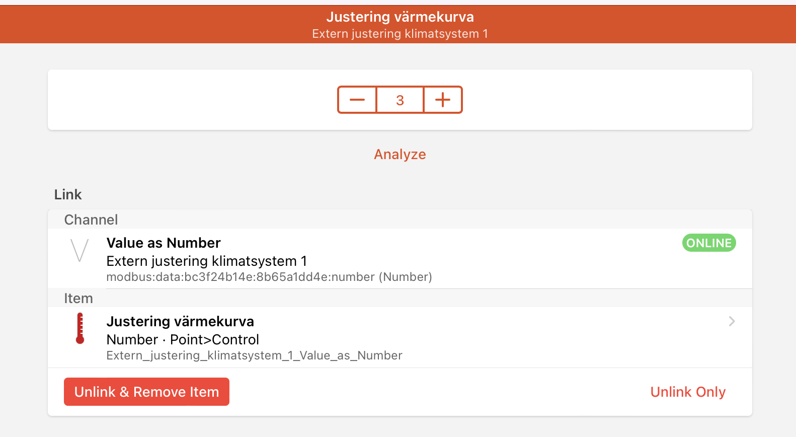

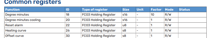

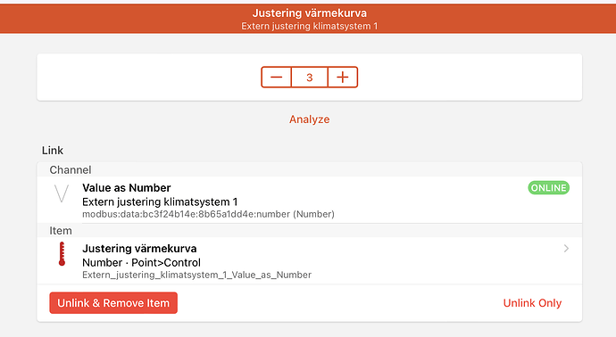

Hi
Can you please post your writing example for writing a new curve to heatpump, I guess that you put your new curve into ID26? I canä’t see any place where one could write indoor or outdoor temperature to heatpump. So logic will need to be completley outside of the heatpump. There is some good examples around here. But I need to know how to successfully write to heatpump.
I’m using register 30 to offset the curve.
Use type “holding register” instead of input register on the Regular Poll Thing (interval 60000, start 30, length 1).
On the Thing for modbus data, use read and write adress 30, read value type “16 bit signed integer (int16)”, write type “holding register” , transform “default”, and write value type “16 bit positive or negative integer, 1 register (int16, uint16)”
