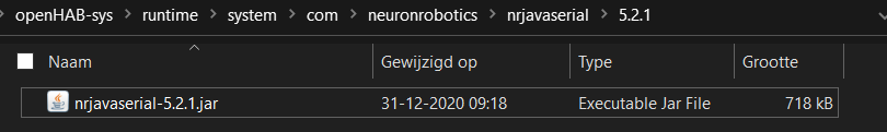

@JamesC You could try the patched JAR I posted here: Modbus binding loses its serial connection every few days without a reason after updating to 2.5.0 Release Build - #16 by fwolter
@fwolter thanks for pointing to the JAR file. Unfortunately it didn’t help.
Did you add EXTRA_JAVA_OPTS="-Dgnu.io.rxtx.SerialPorts=/dev/ttyUSB0" to /etc/default/openhab as stated here Serial Port Configuration | openHAB?
Added the EXTRA_JAVA_OPTS and it is looking better. Will continue to monitor over the next few days. Thanks greatly appreciated.
Did you have success with or without the patched JAR?
Adding the EXTRA_JAVA_OPTS fixed the issue. I was using the patched JAR but have now reverted to the original and it’s working.
The modbus polling stopped after 12 hours with the original JAR. I have gone back to the patched JAR and see how that goes.
Did the patched JAR work for you?

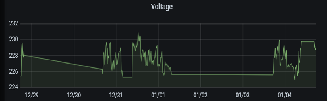

I do have the same symptoms, reading out modbus stops after approx 12h w/o any warning.
I’m not always able to react quickly, but below a screenshot of the voltage. This line is changing constanly, until the modbus stops functioning. After restart openhab (sudo sysemctl restart openhab) the modbus starts working again.
On OH2 it worked ok, difference is OH2 on RPI3 instead RPI4.
Modbus device is SDM120.

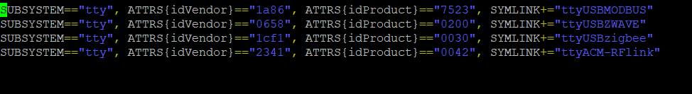

Done until now:
  • created symlinks
  • added symlink to openhab.service
  • used the updated .jar as shown above
Today I reinstalled ZRAM since this configuration has been changed, perhaps this helps. Are there any other idea’s to try if this does not help?

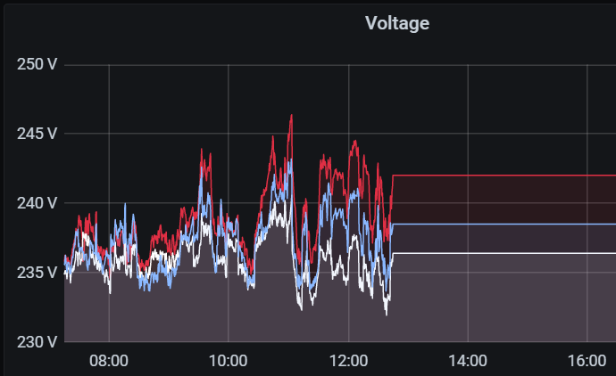

@lampy, the issue you describe has the same symptoms to what I am seeing. I also use an SDM120.
The patched JAR had been working continuously for 2 days but has now failed. The patch JAR is better but the issue still exists. Suggest you update to the patched JAR and turn the modbus DEBUG logging on to capture more info. I am doing the same.

I had updated to the new .jar from @fwolter already earlier.
Screenshot of symlinks:
Screenshot of openhab file:

I also had the modus stop working with the new JAR installed. It held up for about two days.
The readings flatline:
The modus things remain online:
The logfile shows:
