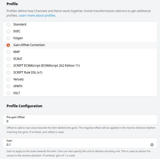

I tried the way with gain and get the following error
2026-04-19 19:35:23.449 [WARN ] [penhab.core.library.items.NumberItem] - Failed to update item âKSEMActive_powerâ because â7.3â could not be converted to the item unit âWâ
This looks like the gain works fine but now the unit is not OK.

2026-04-20 20:37:50.914 [WARN ] [penhab.core.library.items.NumberItem] - Failed to update item âKSEMActive_powerâ because â1766.1â could not be converted to the item unit âWâ
One can also specify the unit to declare resulting unit.
Add the unit to the Gain.
0.1 W
