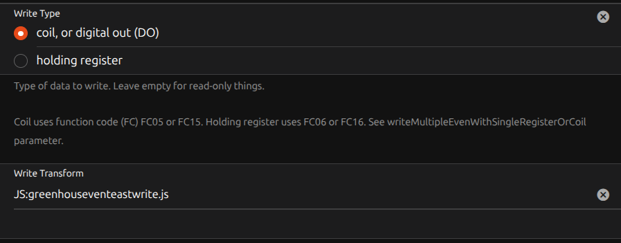

I have done this for channel transforms previously, and these work just fine via the UI. The remaining transform files however are used by the Modbus binding as write transforms within the thing itself, aka:
My transforms work fine when located in the directory, but if I delete them, and recreate in the UI (and update the config), I get the following error:
2025-08-27 11:00:43.304 [WARN ] [ernal.handler.ModbusDataThingHandler] - Cannot process command STOP (of type StopMoveType) with channel modbus:data:greenventcoils:greenventCo0:rollershutter since transformation was unsuccessful
2025-08-27 11:00:44.311 [WARN ] [nelTransformation$TransformationStep] - Failed to use TransformationStep{serviceName='CONFIG', function='js:greenhouseventeastwrite'}, service not found
I have tried various combinations of the configuration to use a ‘UI Based’ transform, e.g.
  • config:js:greenhouseventeastwrite
  • CONFIG:JS:greenhouseventeastwrite
  • js:greenhouseventeastwrite
  • JS(greenhouseventeastwrite)
  • And many other random variants, based on various posts in this community

For UI you need to refer to the transformation name you give in UI like
For file based, it would need to refer to the filename in the transform directory like so
JS(greenhouseventeastwrite.js
Cheers for the response @mstormi, and helping me put my mind at ease that I wasn’t trying to do something completely crazy. I tried a few more combinations with no success, so have now logged a bug for the Modbus add-on: [modbus] UI based write Transform not working · Issue #19270 · openhab/openhab-addons · GitHub
