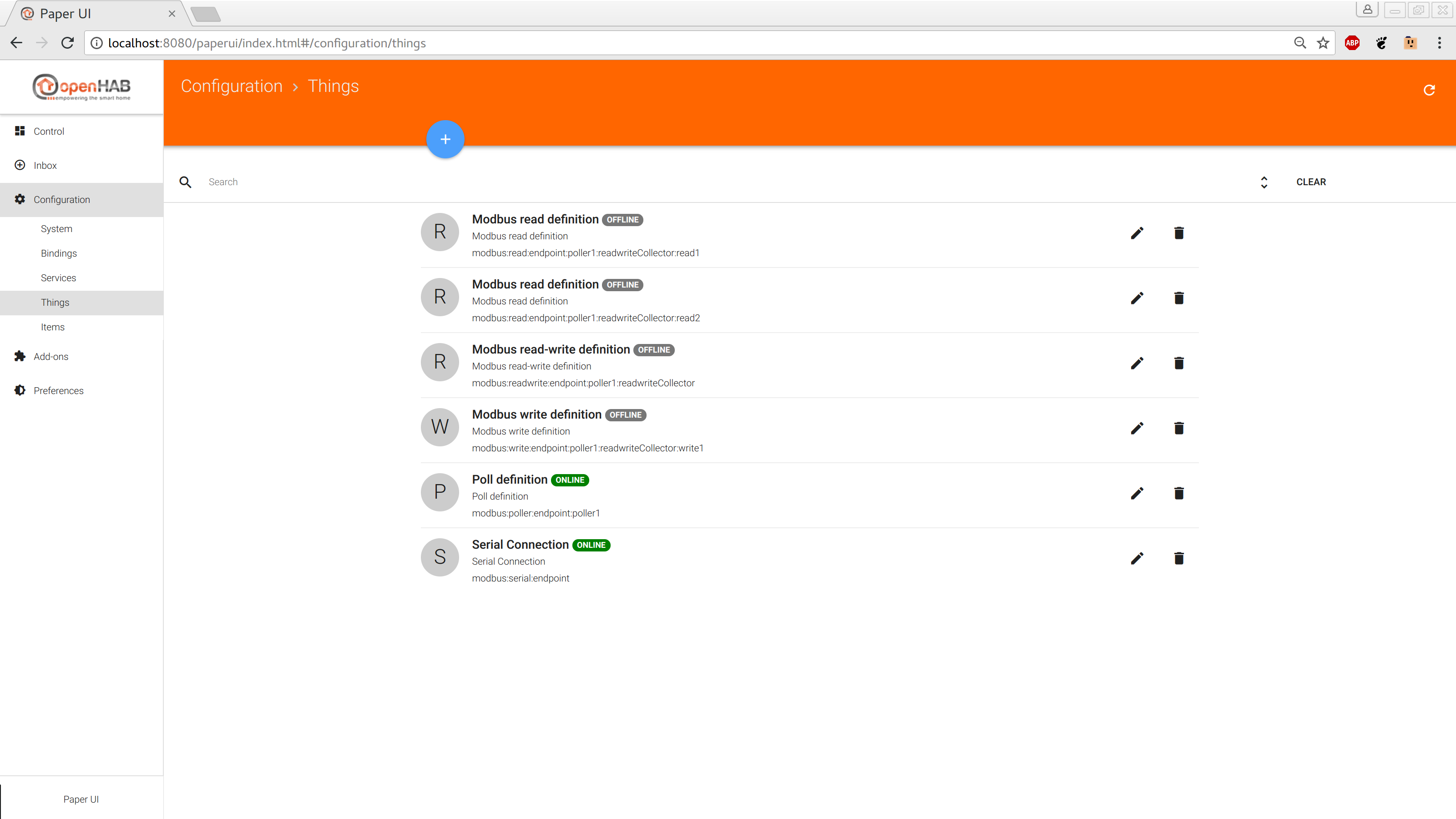

It surely does. The manual configuration should be as easy as possible and once completed should not get into the way anymore. The current implementation creates no less than 6 different things that show up in the Paper UI (screenshot) - and thats just for a single device AND reading/writing to a single register.
For users this is very confusing, especially considering that they have been told beforehand that each thing represents an actual physical device. I suggest that only a single thing should be created for each device.
yeh. Back at the beginning of the thread we established a logical hierarchy to represent Modbus devices ; but it has more layers than OpenHAB provides names for, hence the apparent repetition.
The “simple to use” desire might perhaps be addressed by some kind of templating or add-on - some kind of device specific layer sitting on top of the generic Modbus binding.
