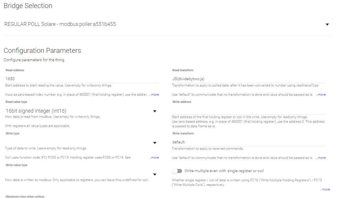

with notepad i have creata a file “dividebytwo” and put it in folder /trasform/ (OK, i make it with windows,
).After with paperUi i have write it:
but don’t work… what i havn’t understand???
Thank’s a lot
Okay, you need to give it some content as well - the actual javascript.
The docs include an example for divide-by-ten. You can modify that for divide-by-two.

i don’t know why, but i have resaved a file, and now work!!!
thank you very much
