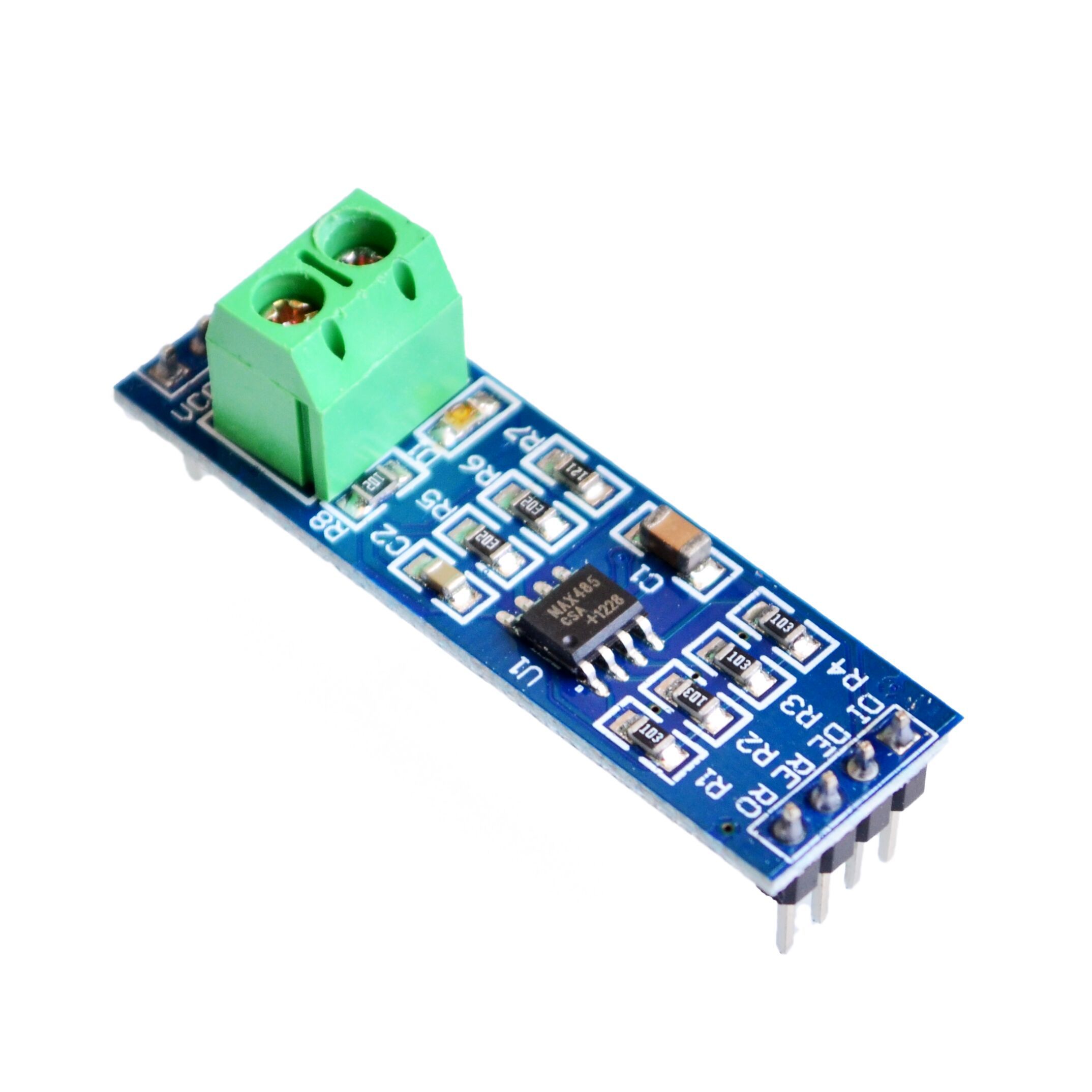

I have also a little problem to understand the Physical interface to my RPI3 GPIO’s. (OH 1.8.3)
I have a little RS485 Module like this:
Can I use this for the Modbus Serial Binding? If yes how should i connect the DE and RE Pins for the FlowControl, I see" flowControlIn" and “flowControlOut” but i don’t know the arguments for the GPIO Pins. I cant found it in de descrition for the Binding.
Or is it necessary to use a USB > RS485 Module? like this:
OK, a TTL to RS485 serial board. You would somehow have to make the Pi use some GPIO pins as a TTL serial interface. That’s a Pi thing, not OH, I have no idea how. The Pi system would need to make the software interface available to OH as a ‘tty3’ or similar port.
Given these things are really cheap, you would need a good reason not to do it that way.
