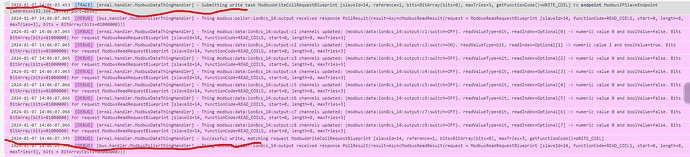

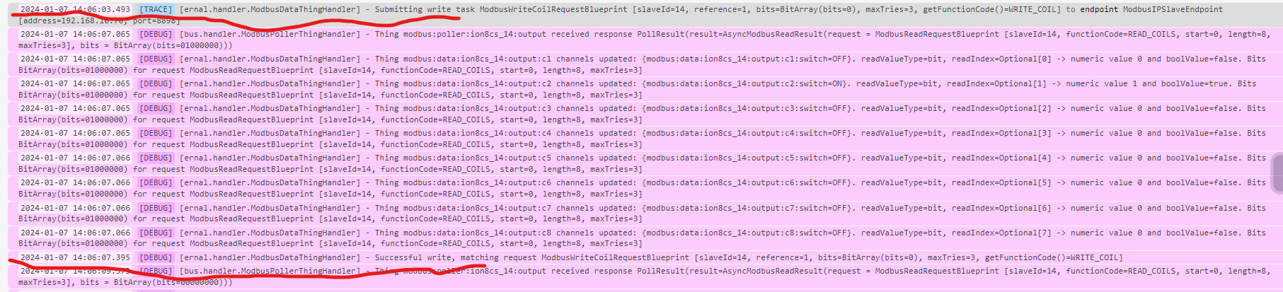

This working well for a year except of incomprehensible delays when write that sometimes happen, sometimes it can be instant, sometimes 2-3-4 seconds.
In the logs I see that at this moment seconds gap between the recording event and confirmation of success. What could be causing this and can it be fixed?
