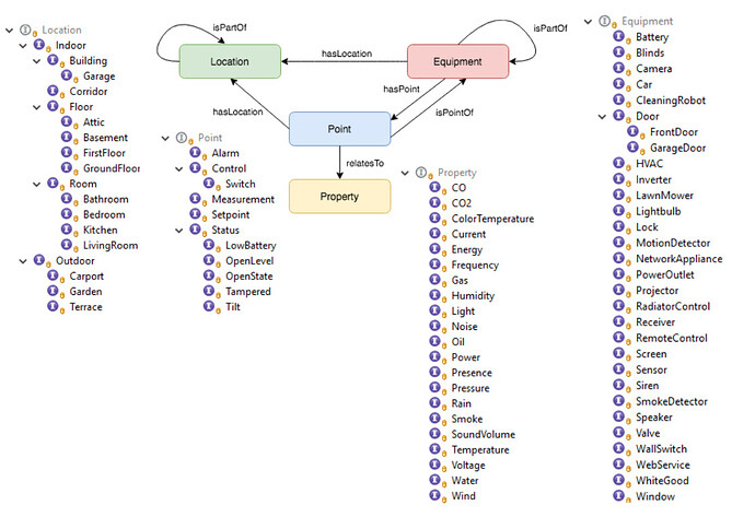

It took me a while to get my head around the Semantic Model, but when it clicked that Locations, Equipment and Points where all just openHAB Items with extra bits of information for openHAB to use for classification, everything became a bit clearer!
Locations = Group Item
Equipment = Group Item
Point = Item (single)
Equipment can live in Locations.
Points can live in Equipment, and can also live in Locations by themselves.
This is probably stuff you know already, but it might be helpful for someone else who stumbles upon this!
I did not get that at all…
As a beginner, I read about the semantic model, and maybe I did not understand it, but having visual memory I remembered this
Now that I reread it I see that they are defined as Group Items.
Just wish that chart for clarity had instead of “Location”"Location item"and so on.
