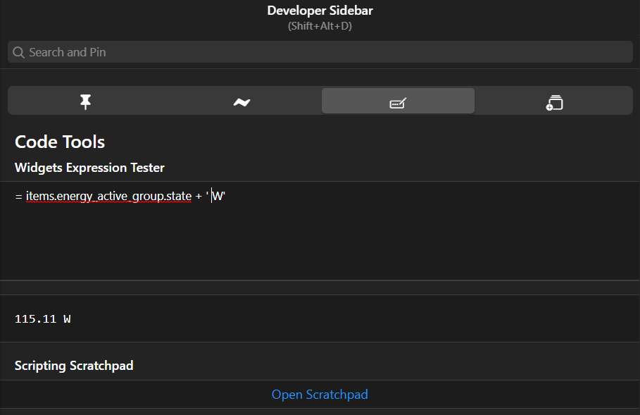

For my specific case in which I wanted to incorporate the value unit in the widgets, I have found another way to do it without having to go through this bug.
My solution is inside a widget to fill the label field with an expression. I attach an example:
Greetings, I hope it helps someone.
