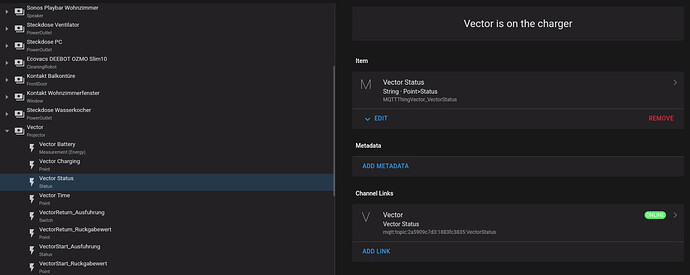

And here is my item:
What am I doing wrong?

In order for
I want the “projectors” badge to be displayed with a custom icon when the item “MQTThingVector_VectorStatus” has the value “Vector is on the charger”
there are (IMHO) two separate steps to achieve the same:
  • I want the “projectors” badge to be displayed when the item “MQTThingVector_VectorStatus” has the value “Vector is on the charger”,
  • setup custom icon for a badge
First you need to prepare your model properly so it will render projector. You will most probably need a rule that will convert a (new?) item’s state (lets call it MQTThingVector_VectorStatusSwitch) to on/off based on MQTThingVector_VectorStatus items value - so if (state of)
MQTThingVector_VectorStatus === 'Vector is on the charger'
then set MQTThingVector_VectorStatusSwitch to ON or OFF otherwise.
If you’ll tag MQTThingVector_VectorStatusSwitch properly within the room you want your projector to appear, that should do the trick for step 1.
As far as I can see, you already covered step 2 yourself in original post, just remove the expression part …
