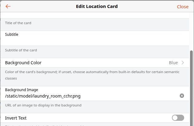

Also on that page you can see other built-in properties such as changing the background color and the image. These you can set using the configure card menu option in the overview page editor (click the pencil icon in the upper right corner of the overview page):

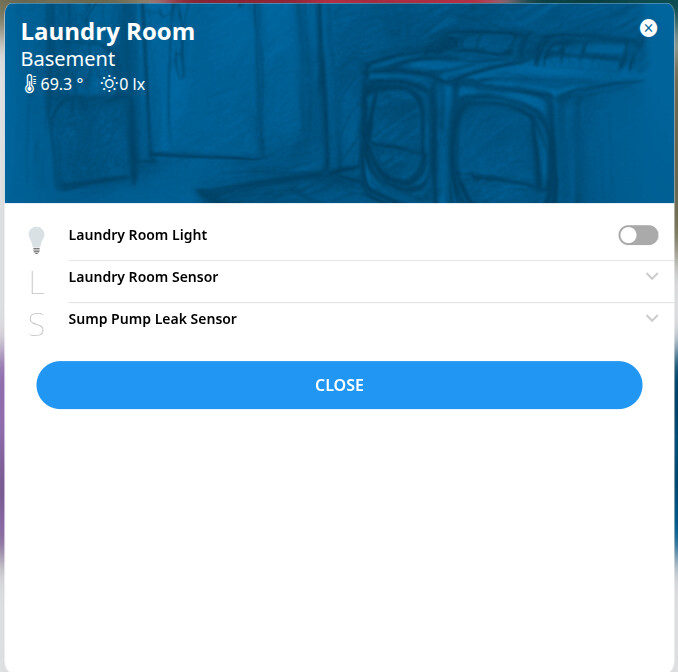

If you need to change more than that you can modify some of the css styles by switching over to the code tab and adding a stylesheet property to the widget’s yaml configuration. For instance, I want my buttons to match the color theme of each card image:
loc_LaundryRoom:
  - component: oh-location-card
      backgroundColor: blue
      backgroundImage: /static/model/laundry_room_cchr.png
      stylesheet: |
        .button-active {
          background: rgb(0,107,166);
        .button-large {
        .button {
          border-color: rgb(0,107,166);
