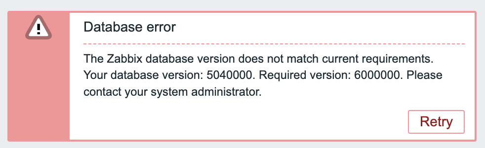

I’d post a screen shot but apparently I’ve got some Zabbix problems after yesterday’s upgrade.
[Edit] OK, the problem was I thought that I was keeping up with PostgreSQL upgrades but I wasn’t. I’m running 11.4 and Zabbix now requires 13. So it’s not a Zabbix problem.

The installation of Zabbix <6 was a real pain in the …, which brought me over the edge of my know-how and i abandend it last year. Zabbix 6 was easy-peasy as the installation script and docu was rewritten.
What I don’t get presently is how to run zabbix or netdata within my Synology Docker, which isn’t as convenient as to “drop the provided docker-script and it’ll run”, but I have to insert the volumes and env-variables and somehow I don’t get this running…
