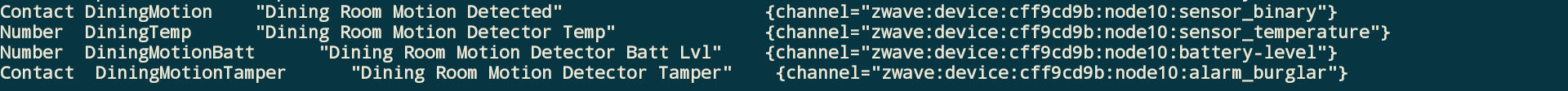

  5. Four channels were automatically created and displayed in the Paper UI ( sensor_binary, sensor_temperature, battery-level, alarm_burlar)
  6. I created four items by cutting and pasting the channel info into the curly brackets for item binding (i.e. {channel=“zwave:device:cff9cd9b:node10:sensor_binary”} as I have with the GE dimmer switches. See items below

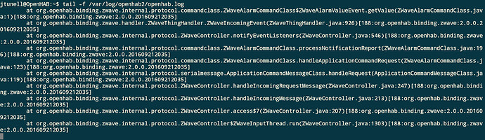

When looking at the Openhab events.log file, after some time, I can see that the battery and temperature are being updated. The issue is the motion and tamper switch are not. Now… When I trigger the tamper switch or the motion sensor I see the following in the events log;
I also see the following in the openhab.log;

I think your log is missing the bit we need to see, but is it possible the ‘type’ is wrong, and these missing items should be a Switch and not a Contact?
I will get a better capture of the log.
I should also add that I originally had the items defined as Switches and not Contacts but I changed them after taking a look at the items created in the binding examples (example) for a Monoprice motion sensor. No difference between the two.
The examples are for openHAB 1 installations. In OH2 some item types have changed. You can find the informations here:
http://www.cd-jackson.com/index.php/zwave/zwave-device-database/openhab-2-channel-types
alarm_burglar and sensor binary are both SWITCH.
Please set the log level to DEBUG and post your log. Produce some motion during logging to see the events…
And do not “capture” the log (NO picture). Copy&Paste the log as preformatted text (see the icons above your posting window) or upload it as a file.

Here is a copy of my log file after setting the zwave binding log level to DEBUG. I also changed the item type to Switch as well. The log is showing what comes up after I trigger the tamper switch by opening the case.
openhab> log:display
16:23:04.222 [DEBUG] [WaveSerialHandler$ZWaveReceiveThread] - Receive Message = 01 11 00 04 00 0A 0B 71 05 07 FF 00 FF 07 03 01 03 00 9E
16:23:04.225 [DEBUG] [ve.internal.protocol.ZWaveController] - Receive queue TAKE: Length=0
16:23:04.226 [DEBUG] [wave.internal.protocol.SerialMessage] - Assembled message buffer = 01 11 00 04 00 0A 0B 71 05 07 FF 00 FF 07 03 01 03 00 9E
16:23:04.226 [DEBUG] [ve.internal.protocol.ZWaveController] - Process Message = 01 11 00 04 00 0A 0B 71 05 07 FF 00 FF 07 03 01 03 00 9E
16:23:04.226 [DEBUG] [ve.internal.protocol.ZWaveController] - Message: class=ApplicationCommandHandler[0x04], type=Request[0x00], priority=High, dest=255, callback=0, payload=00 0A 0B 71 05 07 FF 00 FF 07 03 01 03 00
16:23:04.226 [DEBUG] [ssage.ApplicationCommandMessageClass] - NODE 10: Application Command Request (ALIVE:DONE)
16:23:04.226 [DEBUG] [alization.ZWaveNodeInitStageAdvancer] - NODE 10: Starting initialisation from DONE
16:23:04.226 [DEBUG] [ve.internal.protocol.ZWaveController] - Event Listener org.openhab.binding.zwave.internal.protocol.initialization.ZWaveNodeInitStageAdvancer@22c2f5ac already registered
16:23:04.226 [DEBUG] [ssage.ApplicationCommandMessageClass] - NODE 10: Incoming command class ALARM
16:23:04.226 [DEBUG] [.commandclass.ZWaveAlarmCommandClass] - NODE 10: Received ALARM command V4
16:23:04.226 [DEBUG] [.commandclass.ZWaveAlarmCommandClass] - NODE 10: Process NOTIFICATION_REPORT V4
16:23:04.226 [DEBUG] [.commandclass.ZWaveAlarmCommandClass] - NODE 10: NOTIFICATION report - 7 = 255, event=3, status=255
16:23:04.226 [DEBUG] [.commandclass.ZWaveAlarmCommandClass] - NODE 10: Alarm Type = BURGLAR (7)
16:23:04.227 [DEBUG] [ve.internal.protocol.ZWaveController] - Notifying event listeners: ZWaveAlarmValueEvent
16:23:04.227 [DEBUG] [ding.zwave.handler.ZWaveThingHandler] - NODE 10: Got an event from Z-Wave network: ZWaveAlarmValueEvent
16:23:04.228 [ERROR] [ve.internal.protocol.ZWaveController] - Exception during ZWave thread: Input 2. {}
java.lang.ClassCastException: org.openhab.binding.zwave.internal.protocol.commandclass.ZWaveAlarmCommandClass$Alarm cannot be cast to java.lang.Integer
at org.openhab.binding.zwave.internal.protocol.commandclass.ZWaveAlarmCommandClass$ZWaveAlarmValueEvent.getValue(ZWaveAlarmCommandClass.java:587)[188:org.openhab.binding.zwave:2.0.0.201609212035]
at org.openhab.binding.zwave.internal.protocol.commandclass.ZWaveAlarmCommandClass$ZWaveAlarmValueEvent.getValue(ZWaveAlarmCommandClass.java:1)[188:org.openhab.binding.zwave:2.0.0.201609212035]
at org.openhab.binding.zwave.handler.ZWaveThingHandler.ZWaveIncomingEvent(ZWaveThingHandler.java:926)[188:org.openhab.binding.zwave:2.0.0.201609212035]
at org.openhab.binding.zwave.internal.protocol.ZWaveController.notifyEventListeners(ZWaveController.java:546)[188:org.openhab.binding.zwave:2.0.0.201609212035]
at org.openhab.binding.zwave.internal.protocol.commandclass.ZWaveAlarmCommandClass.processNotificationReport(ZWaveAlarmCommandClass.java:196)[188:org.openhab.binding.zwave:2.0.0.201609212035]
at org.openhab.binding.zwave.internal.protocol.commandclass.ZWaveAlarmCommandClass.handleApplicationCommandRequest(ZWaveAlarmCommandClass.java:123)[188:org.openhab.binding.zwave:2.0.0.201609212035]
at org.openhab.binding.zwave.internal.protocol.serialmessage.ApplicationCommandMessageClass.handleRequest(ApplicationCommandMessageClass.java:119)[188:org.openhab.binding.zwave:2.0.0.201609212035]
at org.openhab.binding.zwave.internal.protocol.ZWaveController.handleIncomingRequestMessage(ZWaveController.java:247)[188:org.openhab.binding.zwave:2.0.0.201609212035]
at org.openhab.binding.zwave.internal.protocol.ZWaveController.handleIncomingMessage(ZWaveController.java:213)[188:org.openhab.binding.zwave:2.0.0.201609212035]
at org.openhab.binding.zwave.internal.protocol.ZWaveController.access$7(ZWaveController.java:207)[188:org.openhab.binding.zwave:2.0.0.201609212035]
at org.openhab.binding.zwave.internal.protocol.ZWaveController$ZWaveInputThread.run(ZWaveController.java:1303)[188:org.openhab.binding.zwave:2.0.0.201609212035]

So… Partial success. I can now get the temp, battery, and Motion (Burglar). I cannot however get the tamper (binary sensor) to come in. I have went as far as rolling back the server (on VM) to before I added the device. I updated the driver then added the device with no “custom” items. No joy on the binary sensor. But to be honest with you I’m not that worried about the tamper switch.
On to the next issue. After rolling the server back and upgrading both Openhab and the zwave binding something broke with the Ecobee binding. So I went back to the current, working, snapshot. The only issue remaining is I see in the logs that the binding is attempting to update node 9 as well as node 10 every time I trigger the motion sensor. I suspect this is due to the fact that when I was trying to get the motion sensor to work I linked (inclusion) it to the zwave controller and the first time it came in as node 9. I then unlinked (exclusion) it then proceeded to relink (inclusion). So I suspect somewhere Openhab or the binding is retaining that device as node 9. Question, does anyone know where I can clean this up at. See the log below of what I’m describing.
13:06:31.488 [INFO ] [marthome.event.ItemStateChangedEvent] - DiningMotion changed from NULL to ON
13:06:31.489 [WARN ] [ome.core.thing.internal.ThingManager] - Cannot delegate update 'ON' for item 'DiningMotion' to handler for channel 'zwave:device:cff9cd9b:node9:sensor_binary', because no thing with the UID 'zwave:device:cff9cd9b:node9' could be found.
Alright… A little more investigation reveals that openhab has node 9 linked still (see below). How can I delete this link?

You should be able to find the items under either Habmin or PaperUI under Items and delete them.
