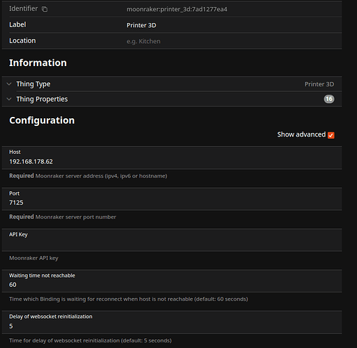

After the binding was installed (via Marketplace or adding the jar manually), you have to add a new Thing with the Moonraker/Klipper Binding
Then you have to manually add a “Printer 3D” Thing
And finally make the initial configuration of the thing, where normally only the Host/IP-Adress of the Printer/Client has to be configured
In the advanced config part you could also configure a other port, api key (not needed if not configured on moonraker/klipper side), or change the timeouts for the websocket reconnect

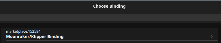

I am not seeing this in the marketplace
I am running 4.1.1
I had to turn on the unpublished stuff

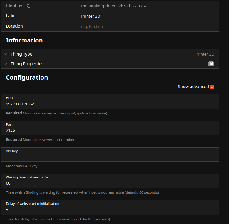

Hi, I just tried installing the binding. However after connecting the Printer (It shows ONLINE), all channels are NULL and stay like that. What am i missing?

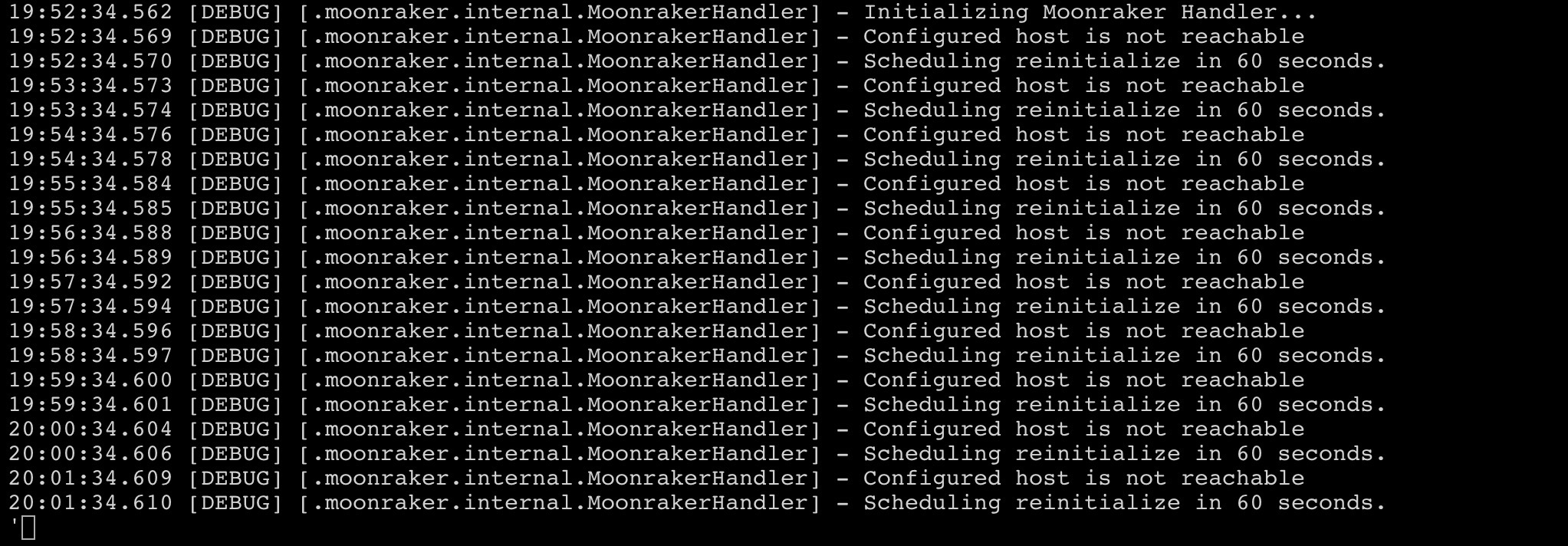

I added two printers … one works … other not.
Cummication Error.
Both use same Moonraker.conf and same Moonraker Version.
The host is reachable.
Both moonraker api are reavhable through port 7125. I also run Obico on both printers … and Obico can reach both using same ips and ports.
Moonraker.log on printer shows:
2026-01-28 20:33:47,342 [authorization.py:_check_trusted_connection()] - Trusted Connection Detected, IP: 192.168.178.111
2026-01-28 20:33:47,440 [application.py:log_request()] - 404 GET /printer/objects/query?gcode_move=speed_factor,speed,extrude_factor,gcode_position&toolhead=print_time,estimated_print_time,max_velocity,max_accel,max_accel_to_decel,square_corner_velocity&extruder&heater_bed&fan&idle_timeout&virtual_sdcard&print_stats=total_duration,print_duration,filament_used&display_status&heaters&mcu=last_stats&mcu%20rpi=last_stats&temperature_sensor%20raspberry&temperature_sensor%20TMC5160&temperature_fan%20chamber (192.168.178.111)
192.168.178.111 is openhab.
