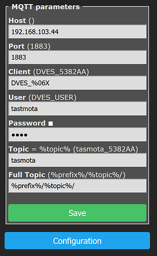

I configured the port as follows:
lxc config device add OpenHAB myport1883 proxy listen=tcp:0.0.0.0:1883 connect=tcp:127.0.0.1:1883
