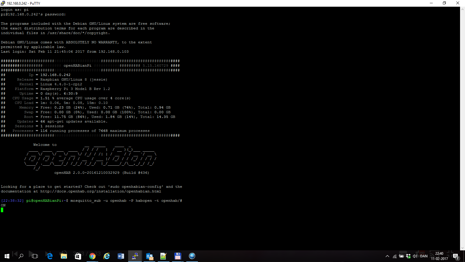

can I somehow see in mosquitto if it receives data from the Sonoff
Hi Brian,
Yes, you can use the subscribe command to monitor the topic that sonoff is publishing messages to.
mosquitto_sub -u openhab -P habopen -t <sonoff_topic> -v
If you don’t know the topic that sonoff uses, you can use (#) for the topic or use a client for MQTT (like: MQTT.fx and subscribe to all topics (#))
