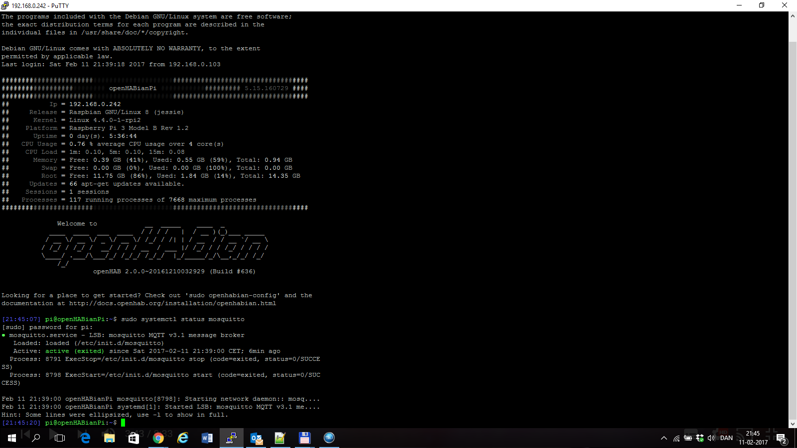

and this is for systemctl status mosquitto
I am scratching my head … :slight_smile: It should have worked…

also: check the systemctl status mosquitto to see what it says…
Somehow your mosquitto server is not working…?
it’s broken… It shows “active (exited)” when it should be showing “active (running)”…
Check the /var/log/mosquitto/mosquitto.log for errors
try to apt-get update and then apt-get upgrade mosquitto
If this doesn’t help: apt-get remove mosquitto and then apt-get install mosquitto
