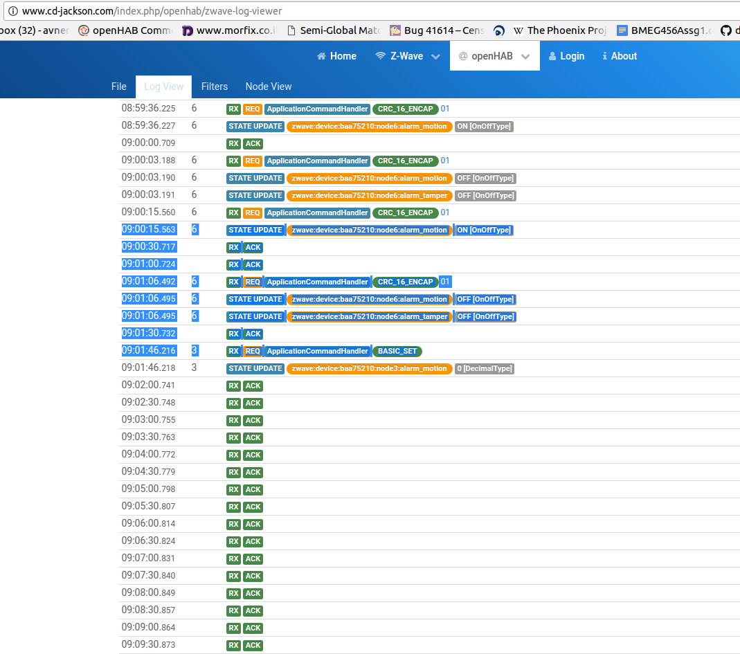

note1 - Starting of oh2
08:54:30.276 TX REQ SerialApiGetCapabilities
note2 OFF/ON events coming from the HASM100 and Fibaro devices
09:00:15.563 6 STATE UPDATE zwave:device:baa75210:node6:alarm_motion ON [OnOffType]
09:01:06.495 6 STATE UPDATE zwave:device:baa75210:node6:alarm_motion OFF [OnOffType]
09:01:46.216 3 RX REQ ApplicationCommandHandler BASIC_SET

Ok, so maybe the lack of messages is something else. As I suggested, I wonder if there’s another exception somewhere that is causing the receive thread to exit. Another suggestion is that something bad is happening earlier so that the binding stops processing received data, and then at some point later, you get the queue full.
I can’t tie up the exceptions with errors in the logs as the different logs don’t tie up for me.
The error you show above at 09:00:15 is this one -:
2017-05-06 09:00:15.560 [Handler$ZWaveReceiveThread] - Receive Message = 01 13 00 04 00 06 0D 56 01 71 05 00 00 00 FF 07 08 00 E8 89 51
This is on the 6 May. If I look in the OH2 log, there is no error at this time on the 6th May. There are 3 exceptions in the OH2 log -:
2017-04-17 05:43:28.805 [ERROR] [WaveSerialHandler$ZWaveReceiveThread] - Exception during ZWave thread.
2017-04-29 02:02:28.219 [ERROR] [WaveSerialHandler$ZWaveReceiveThread] - Exception during ZWave thread.
2017-05-04 06:36:31.001 [ERROR] [WaveSerialHandler$ZWaveReceiveThread] - Exception during ZWave thread.
None of these tie up with either of the logs that you show in note1 or note2 (I’m assuming that’s what you are trying to say when you said it ties up with “this” - “this” being the exceptions?).
Is that what you are trying to show with the log images above?
