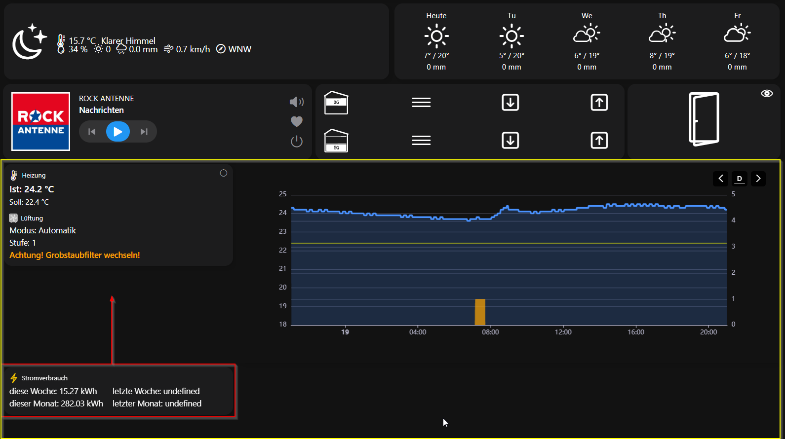

here’s my main-ui page (responsive), with a row (yellow) and 3 columns. obviously the order is “Heizung” > Chart > “Stromverbrauch”
If all your elements are in their own columns in the row then the only reason that “Stromverbrauch” is below “Heizung”, is that all three don’t fit across one level of the row and and the row is flexing the last element down to a second row. The first row will always have the height of the tallest element (the chart) so “Stromverbrauch” is as high as it’s going to get without position shenanigans (which will be very difficult to make appropriately responsive).
The solution is to re-think your structure. If you want “Heizung” and “Stromverbrauch” is a column next to the chart, then give the elements exactly that structure.
Didn’t realize you were working with grids instead of f7 rows and cols. The grid system is really only designed around one single direct child per element. So, in that case you need to convince it that your two widgets are “one element” by making an f7-col the direct child of the grid-col and putting both the custom widgets in that f7-col.
