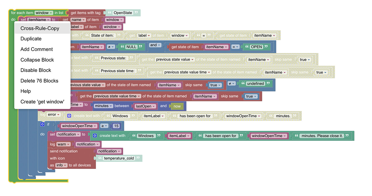

Openhab 4.0 will have blockly 9.0 which has a cross-copy function. With that you can copy a blockly tree between multiple tabs. @stefan.hoehn posted some screenshots about the feature.
