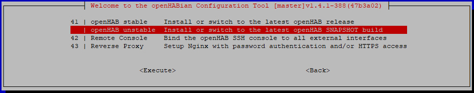

If you use openHABian
Not openhabian, I am afraid, Ubuntu Linux
sudo runtime/bin/update 2.3.0-SNAPSHOT https://docs.openhab.org/installation/linux.html#upgrade
or Moving from Stable to Snapshot - #10 by Dim
