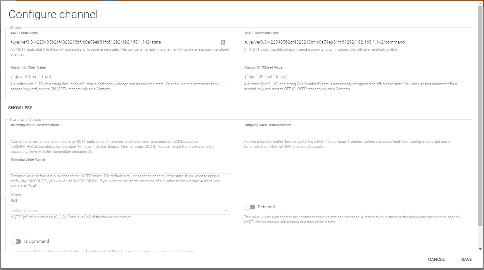

i have kept the existing items with the 1.x format
i have added some new items in the 2.5 format to support my tuya items like explained below

the command topic is well working
the state do not work yet. i need to parse the json file
