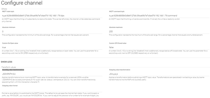

As per the following discussion,
the proper solution to control the tuya brightness should be to add { “dps”: 2, “set”: %d} to the Outgoing Value Format (OVF) but it seems that the %d is not properly processed by OVF at that stage.
The temporary workaround is to not use OVF but to add the following Javascript transform
(function(brightness) {
var tuyaobj = {"dps": 2, "set": Math.floor(brightness)};
var data = JSON.stringify(tuyaobj);
return data;
})(input)

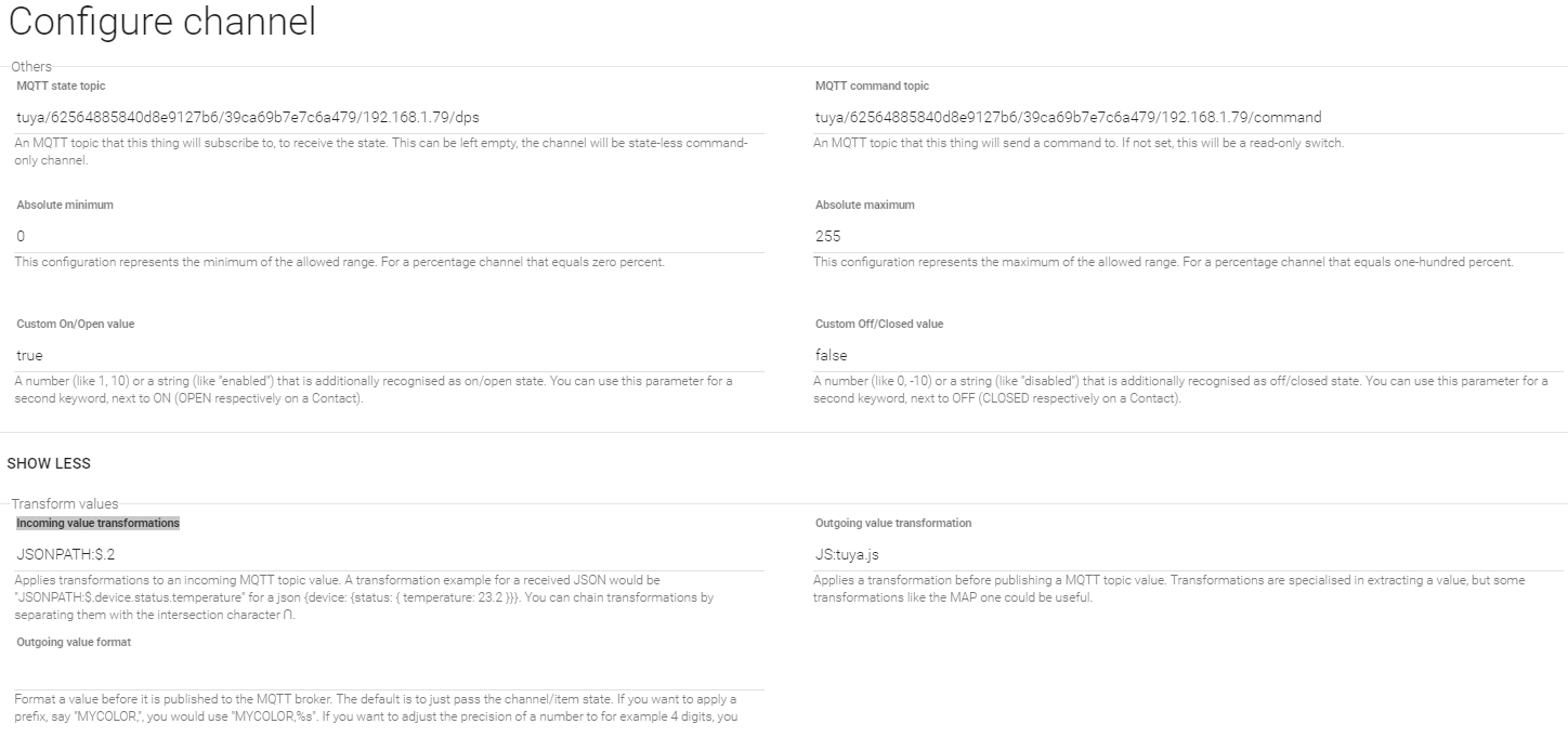

JSONPATH:$.2 must also be added to the channel “Incoming value transformations” to process properly the dimmer state.
The complete channel set up is:
