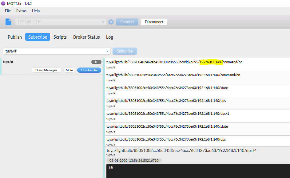

i have bought those two lightbulbs
https://fr.aliexpress.com/item/4000071916147.html?spm=a2g0o.detail.100009.5.4c4519a07614uo&gps-id=pcDetailLeftTopSell&scm=1007.13482.95643.0&scm_id=1007.13482.95643.0&scm-url=1007.13482.95643.0&pvid=80dd6538-bb1a-4270-b84e-4650ab25be69
https://fr.aliexpress.com/item/33018729697.html?spm=a2g0o.detail.100009.1.4c4519a07614uo&gps-id=pcDetailLeftTopSell&scm=1007.13482.95643.0&scm_id=1007.13482.95643.0&scm-url=1007.13482.95643.0&pvid=80dd6538-bb1a-4270-b84e-4650ab25be69
  1. I have used an android rooted phone with Smartlife 3.6 to extract local key
  2. I have well configured the tuya-mqtt service
it’s well working for the first lightbulb
tuya/lightbulb/83051002cc50e343f55c/4acc76c34273ae63/192.168.1.140/command/on
but for the second lighbulb, it’s not working. in spite that i can see that the mqtt commands are well sent from openhab but the bulb do not get turned off or on
tuya/lightbulb/550700402462ab453e00/c86653bc8dd7b695/192.168.1.141/command/on
