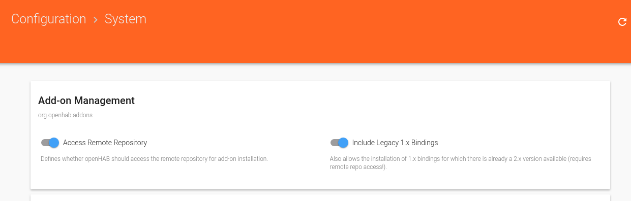

You have to enable this:
“Include Legacy 1.x Bindings”
This will bring the old MQTT binding back.
