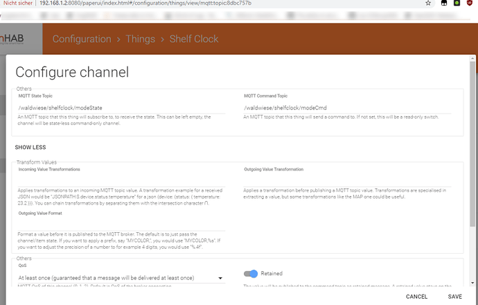

I’m using mosquitto as MQTT Broker with openhab 2.5.3.
My setup is working so far but all messages are sent as QOS 0.

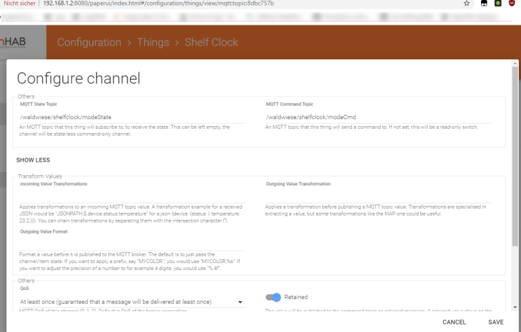

In the Paper UI I setup the Broker connection with QOS1
And also set the channel to QOS1:
However looking at the debug log of mosquitto shows:
1586939556: Received PUBLISH from openHab (d0, q0, r1, m0, ‘/waldwiese/shelfclock/modeCmd’,… (4 bytes))
q0 = QOS 0 retain flag (r1) is sent though
Also it shows that openhab is subscribing at QOS 0:
1586938824: Received SUBSCRIBE from openHab
1586938824: /waldwiese/shelfclock/modeState (QoS 0)
1586938824: openHab 0 /waldwiese/shelfclock/modeState
1586938824: Sending SUBACK to openHab
