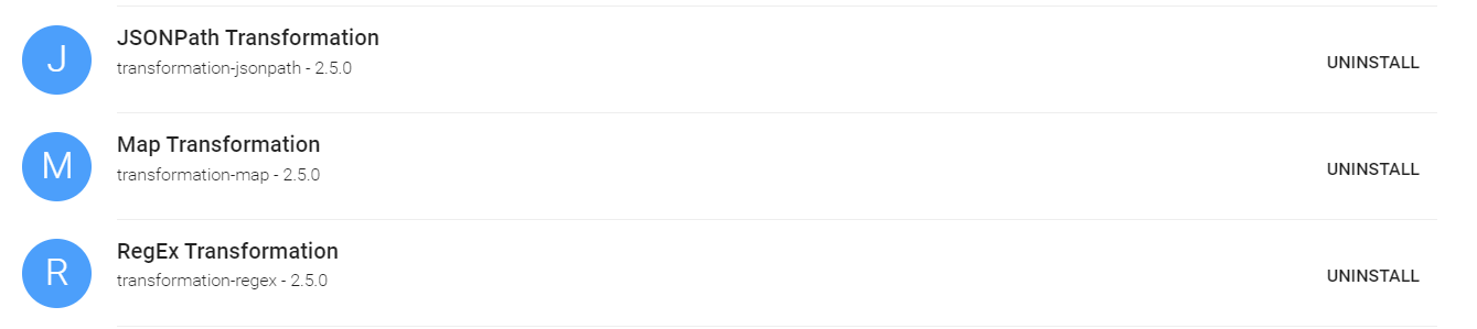

Both the REGEX and JSONPATH transformations are installed?
yes

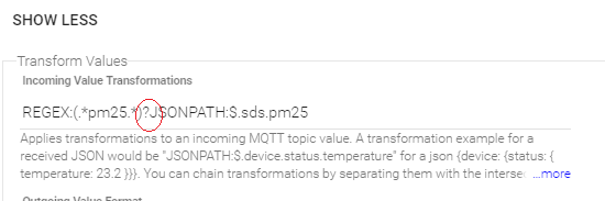

It looks like you are using a Things file. Maybe there is something unique about how you need to write it there. In PaperUI you would not surround the whole expression with “”.
I checked in PaperUI and looked there:
only JSonPath:
RegEx + JsonPath
got it, it’s working as long as the channel type is a string…:frowning:

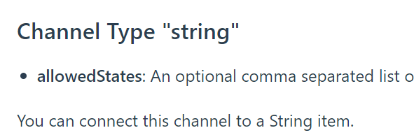

AdditionalQuestion:
Is it possible to link a number item to a string channel?
Then it would not make much a difference if the channel is already a number or not ?
according to the docs not:
Okay, either ignoring the warnings or use string and transform in a rule…

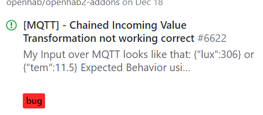

I don’t think so. If it only works for the String channel you may need to file an issue. How to file an Issue
opend an Issue

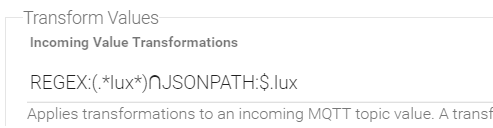

@rlkoshak the problem with regex chained with json resolved in 2.5 release but new problem appeared. After restarting OH in PaperUI in transform value field symbol “∩” replaced with ? and item stop get new values. I suppoused this problem in unicode encoding but how i canresolve it? I add in start.sh file
this string: export EXTRA_JAVA_OPTS=“-Dgnu.io.rxtx.SerialPorts=/dev/ttyS0:/dev/ttyS1 -Dfile.encoding=UTF8” but it not resolve this problem, but resolve another problem with unicode symbols in paperUi web interface.
What happens if you edit the field again copying the ∩ from the text under that field and replacing the “?” with it? Does it revert back to ? or does that fix it?
Now working just fine. I copied this symbol after restarting OH with -Dfile.encoding=UTF8 option.
The symbol did not change after restart OH.

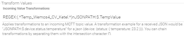

I’m also trying to move my OpenHAB 2.4 configuration with MQTT v1 binding towards a test config with OpenHAB 2.5.1 and the new MQTT v2.5.1 binding. My config is completely text based for 2 reasons: I generate all things, items, rules and sitemaps from a small Python script; secondly: it enables me to easily copy parts of the configuration from one OpenHAB instance to another. I really need thorough testing to avoid issues with our heating system and big trouble with my wife :open_mouth:
I tried to use same combination of transformations, but I can’t get the special “∩” saved: it’s converted into the letter “n”. I also tried to add this line in the /etc/default/openhab2 file:
EXTRA_JAVA_OPTS=“-Dfile.encoding=UTF8”
but no luck.
Here’s what I’ve got in the old items file (MQTT v1 binding):
Number Temp_Wemos4_CV_Ketel “Wemos4_CV_Ketel_T [%.2f C]” (gTemperature) {mqtt="<[mozquitoin:MBroadCast:state:JSONPATH($.TempValue):."Temp_Wemos4_CV_Ketel".]"}
And I added this in the new things file (MQTT v2.5.1 binding):
Thing topic MBroadcaster "MBroadcastR1" @ "MBroadcast" {
Channels:
    Type number : Temp_Wemos4_CV_Ketel "Wemos4_CV_Ketel_T"    [ stateTopic="MBroadCast", transformationPattern="REGEX:(.*Temp_Wemos4_CV_Ketel.*)∩JSONPATH:$.TempValue" ]
When looking in PaperUI I see this:
No errors in the logs… All help is welcome.
There is debate in java circles about UTF8 or UTF-8
How you can put this symbol? I put it by COPYING ctrl c ctrlv in to paperui. But in my situation all cyrillic symbols was ‘?’. Adding UTF8 option resolve this problem in my case.
It’s working fine now. I first started to implement it via PaperUI and it worked immediately. After that I came to the conclusion that my text editor didn’t really save the file in UTF8 format, even though I explicitely set the option. I had to change the “default encoding” of the editor to have it right.

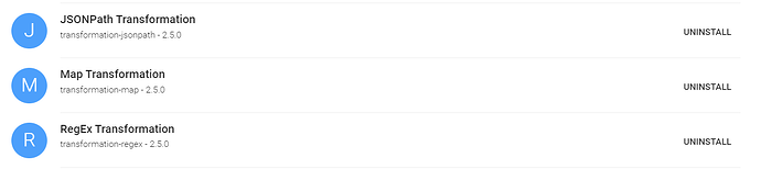

Doesn’t look like you have the REGEX transformation service installed?
PaperUI → Add-ons → Transformations → RegEx Transformation → Install
