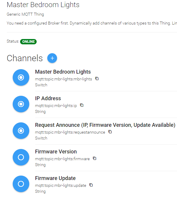

When we are done, the Thing will look something like:
Request Channel
MQTT command topic: shellies/<shelly name>/command
Custom On/Open value: announce
Custom Off/Closed value: announce
Replace <shelly name> with the name of your specific device which you can find on config web page for the device. You need to know this anyway to command the device. For example, shellies/shelly1-25A289/command.
Any time the Switch linked to this Channel receives any sort of command, it will publish “announce” to the device’s command topic.
IP Address
MQTT state topic: shellies/announce
Incoming value transformations: REGEX:(.*<shelly name>.*)∩JSONPATH:$.ip
The trick is the REGEX needs to match the full message, hence the parens around the full expression. But we only want to pass on messages that include this device’s name. As above, replace <shelly name> with the real name. For example REGEX:(.*shelly1-25A289.*)∩JSONPATH:$.ip.
The rest of the fields in the JSON can be extracted in the same way using a different JSONPATH expression.
