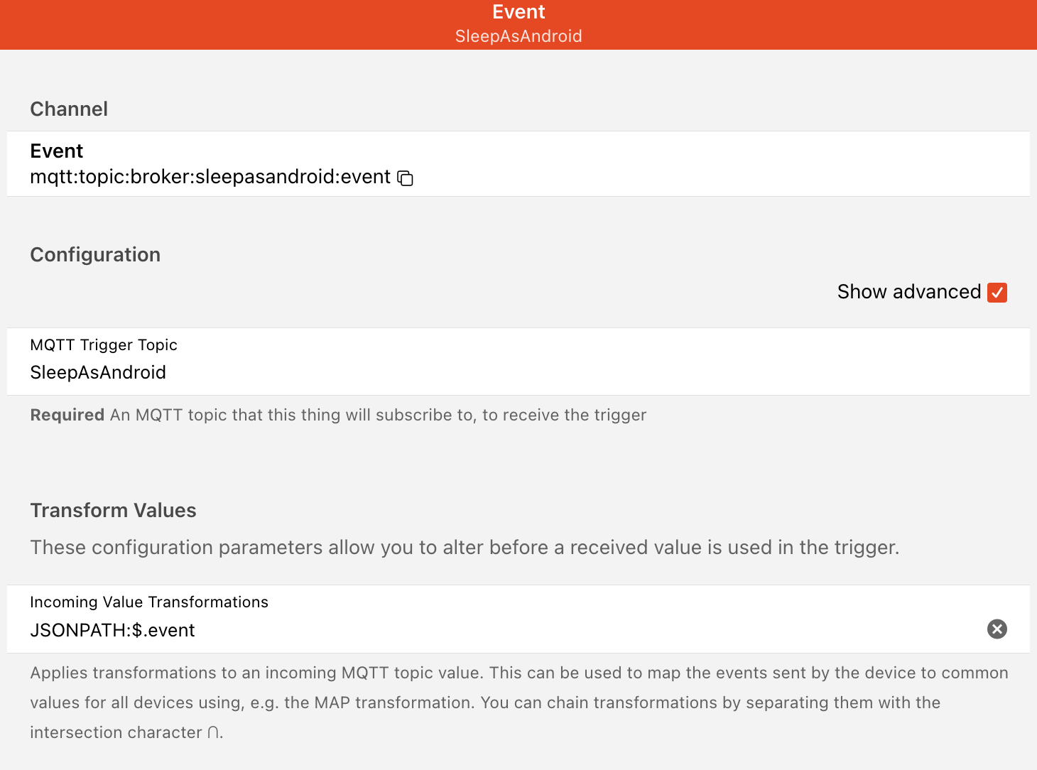

I set it up as follows:
MQTT Trigger Channel:
UID: mqtt:topic:broker:sleepasandroid
label: SleepAsAndroid
thingTypeUID: mqtt:topic
configuration: {}
bridgeUID: mqtt:broker:broker
location: Phone
channels:
- id: event
channelTypeUID: mqtt:trigger
label: Event
description: ""
configuration:
stateTopic: SleepAsAndroid
transformationPattern: JSONPATH:$.event

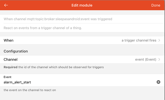

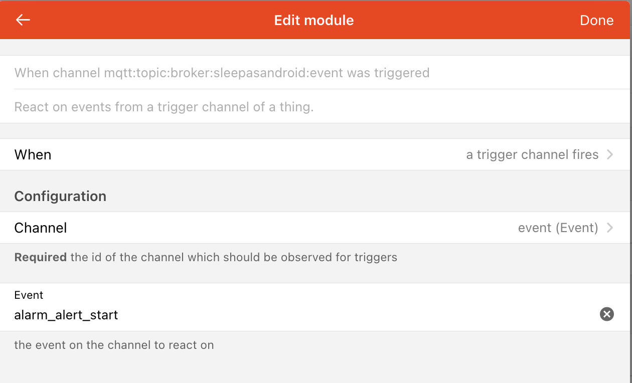

Rule Trigger:
configuration: {}
triggers:
- id: "2"
configuration:
thingUID: mqtt:topic:broker:sleepasandroid
channelUID: mqtt:topic:broker:sleepasandroid:event
event: alarm_alert_start
type: core.ChannelEventTrigger
