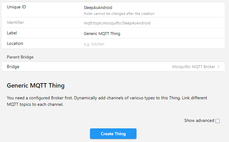

Create a thing in openHAB
Add a Generic MQTT thing in openHAB, attached to your MQTT broker. I’ve used SleepAsAndroid as the Unique ID.

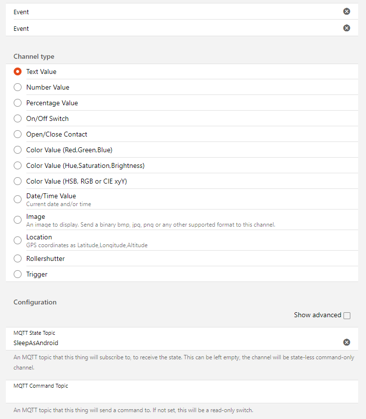

Now, create a single channel with the following parameters:
  • Channel identifier: Event
  • Label: Event
  • Channel Type: Text Channel
  • MQTT State Topic: SleepAsAndroid
The MQTT Command Topic is blank, since we can’t send commands to Sleep As Android.

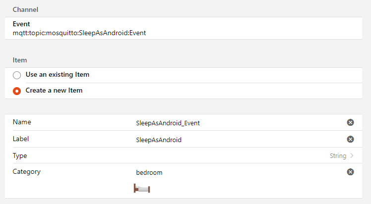

Create an item
Finally, link the channel to a new string item. I’ve used the bedroom category for mine, because it kind of makes sense.
You now have a working item to receive events from Sleep As Android. Open the app on your phone, go back to MQTT settings, and press the “Test” button. You’ll get this in your log:

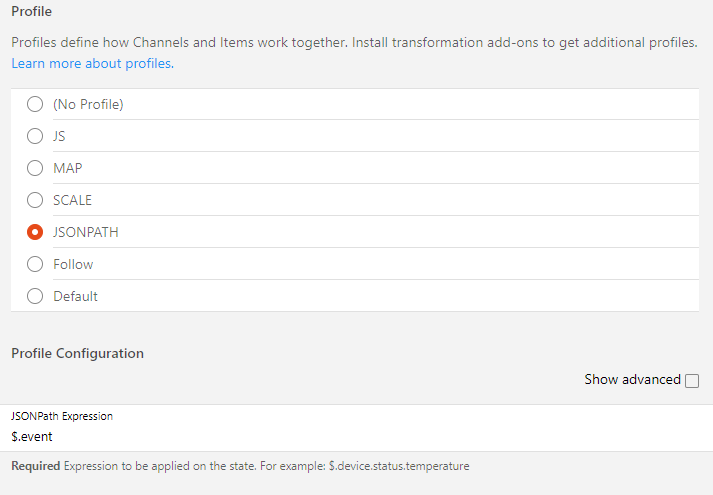

Transform the state with JSONPath
  1. Go back to your item, then click on the Event channel.
  2. Scroll down to Profile and select JSONPATH.
  3. In the “JSONPath Expression” field, type $.event.
  4. Save the change.
This will extract the data for the event and ignore everything else. Once again, click the “Test” button in the app. You should get this:
Item 'SleepAsAndroid_Event' changed from {"value1":"1611764100000","value2":"","event":"alarm_alert_start"} to Unknown
And the next time your alarm goes off, you’ll get alarm_alert_start.
