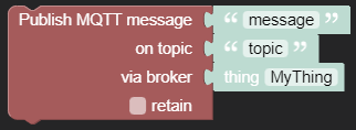

This library adds a block to perform MQTT actions. You need the MQTT binding installed and a configured broker Thing.
Blocks
This block will publish the provided message on the provided topic via the specified broker, which you can select in a popup by clicking inside the thing block. Only choose a MQTT broker when picking the thing.
You can optionally retain the message on the broker.

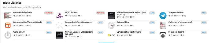

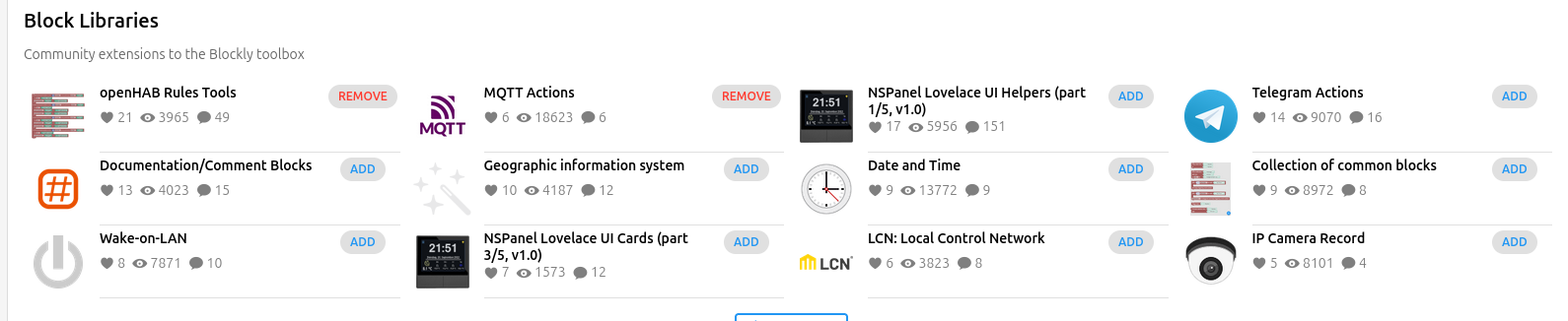

Ahhh, this is for the blocky language. I was wondering all along what this is. It should say so in the addon store. It has the same icon as the mqtt binding too.
rlkoshak
(Rich Koshak)
August 18, 2025, 2:33pm
7
It is in the Block Library category. Everything posted in Add-on Marketplace â Block Libraries is for Blockly. In MainUI â Add-on Store ->Automation, everything under the âBlock Librariesâ is for Blockly.

tried out to follow your recommendations within this thread, but am not able to install this block library âMQTT Actionsâ through the Main UI. Simply canât find it if i follow your description. May it be, that the section âBlock Librariesâ disappears together with the community marketplace bindings? Am running OH 5.0.3 on Windows11.
rlkoshak
(Rich Koshak)
December 10, 2025, 2:10pm
10
Block libraries are posted to the marketplace, so if the community marketplace isnât enabled you wonât see Block libraries.
