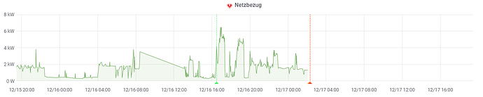

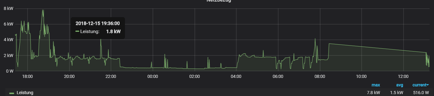

My mqtt and influxdb streams suddenly stop working. I experienced this before, and now I upgraded to 2.4.0 RC1 . After gettingrid of the Z-Wave issues I have the same “old problem” again.
Best to see in the screenshot below - Openhab suddenly stops storing values in the InfluxDB:
It worked the whole night until 8:26 h a.m. Then I restarted openhab by using
sudo /bin/systemctl restart openhab2.service
and so it started to work again at 12:04 p.m. Additionally also the mqtt submission does not work anymore at the same time.

The only rules I found which could occur at 5 minutes past 2 a.m are:
var Number varStromkosten = 0.18
rule "Wh in kWh" //divide by 1000 for better visualization
       Item eumelEFAT received update or Time cron "0 */5 * * * ?"
      var Number WhBezug = eumelEFAT.state as DecimalType
      var Number kWhBezug = WhBezug/1000
      var Number EuroBezug = kWhBezug*varStromkosten
      postUpdate(eumelEFATKWH, kWhBezug)
      postUpdate(eumelEFATEURO, EuroBezug)
      logInfo("Rules", "Euro und kWh Bezug updated to: "+eumelEFATKWH.state)
rule "YTD energy values"
    val Yearbeginn = now.withTimeAtStartOfDay.withDayOfYear(1)
      logInfo("Rules", "Datum: "+Yearbeginn)
    var Number YTDBezug = eumelEFATKWH.deltaSince(Yearbeginn)
    logInfo("Rules", "YTD Bezug updated to: "+YTDBezug)
    if (YTDBezug == null) {
      eumelEFATYTD.postUpdate(eumelEFATKWH.state)
    else  {
    postUpdate(eumelEFATYTD,YTDBezug)
    logInfo("Rules", "EFATYTD updated to: "+eumelEFATYTD.state)
rule "Day energy values"
  var Number Energycons2day = eumelEFATKWH.deltaSince(now.withTimeAtStartOfDay())
  postUpdate(eumelEFAT2D,Energycons2day)
  logInfo("Rules","Energy consumption today updated to"+eumelEFAT2D.state)
  var Number Energycost2day = ((eumelEFAT2D.state as DecimalType)*varStromkosten)
  postUpdate(eumelEFAT2DEURO,Energycost2day)
  logInfo("Rules","Energy cost today updated to"+eumelEFAT2DEURO.state)
I will deactivate these rules…just a guess..
Anything obvious in your eyes?
Regards,
Herbert
I don’t think it’s the Rules. I think the Rules might be a symptom of the same problem. Something is happening, perhaps a flurry of events, that is causing OH to run out of threads or something like that and preventing it from processing the events.
any hint how to proceed - what kind of logging could point me to a solution (problem)?
I just restarted the openhab service → working again
thank you
Look at your system usage and start to systematically disable Rules or addon’s and the like until the problem stops happening. I don’t have any good suggestions.
OK - thank you! Concerning sytem usage, I did not find anything suspicious…will post an update, if I can find anything.
