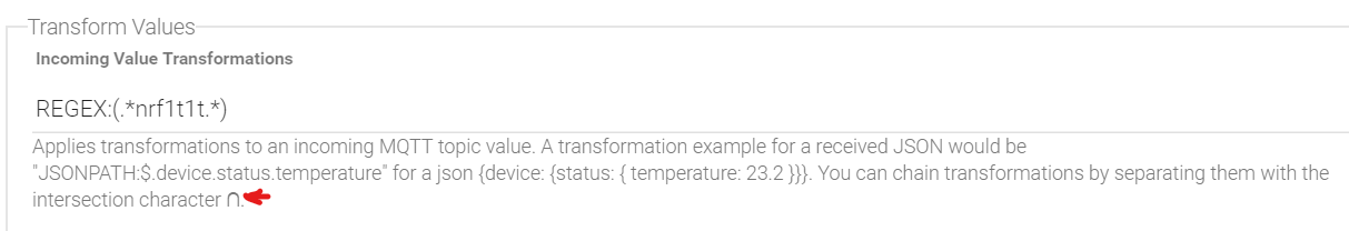

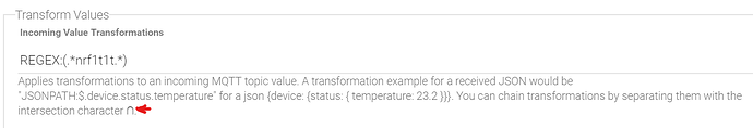

How to get this symbol by Keyboard? Is it a common symbol in US?
No, it’s not common at all. I’m sure there is some key combo one can type to bring it up (like the degree symbol which is another similar annoyance for those on a US keyboard) or one can use the Symbol Map (if it still exists on Windows). I’m personally very unhappy with the choice of this symbol but I’m not a dev so don’t have much weight to complain.
As yet another reason why I push creating Things in PaperUI, I usually just copy the symbol from the instructions under the transformation field in the form and paste it in place. If I were to use .things files, I would probably copy and paste the symbol into a comment so I can copy/paste in that file.
Just as I did for the question :smile:
