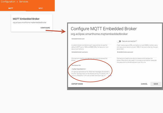

I’ve migrated my openHAB configurations from PaperUI to files. Everything is finally working fine, but I’m wasn’t able to configure a persistence file (UI parameter persistenceFile) for the broker. I’m using the embedded MQTT service. Any hint how to do this?
Right now - no. But unless the behavior from configurations via PaperUI and via file is so different I would like to know why. In addition: MQTT persistence service? That’s nothing I’ve installed in my PaperUI configuration. AFAI know it’s just a bin file, where incoming messages are stored unless they’re processed.
Yes, we are talking about different things. This is the data for retained messages.
Retained messages are used for the persistence service but it is configured via a persist file.
