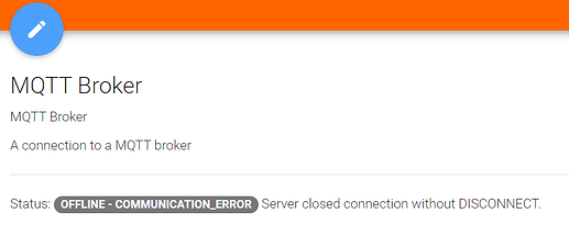

MQTT broker - Server closed connection without DISCONNECT

Okay, so I’ve now done this:
  • Created a brand new VM
  • Installed Ubuntu 18.04 LTS (no post install updates applied)
  • Installed zulu-8
  • Installed openhab2.5 main
  • Added MQTT Binding
  • Added MQTT Broker thing
  • Configured broker exactly as other systems

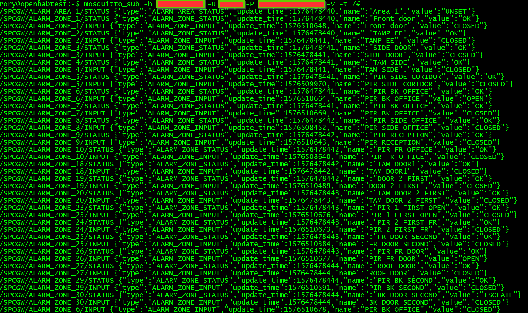

Same error again, yet mosquitto_sub works fine:
I also installed openhab 2.4 on Synology and the broker works fine on that.
Finally, I downgraded my main box from 2.5.0-1 to 2.4.0-1 and the broker started working again. Upgraded back to 2.5.0-1 and the broker stops working again. So I got busy upgrading…

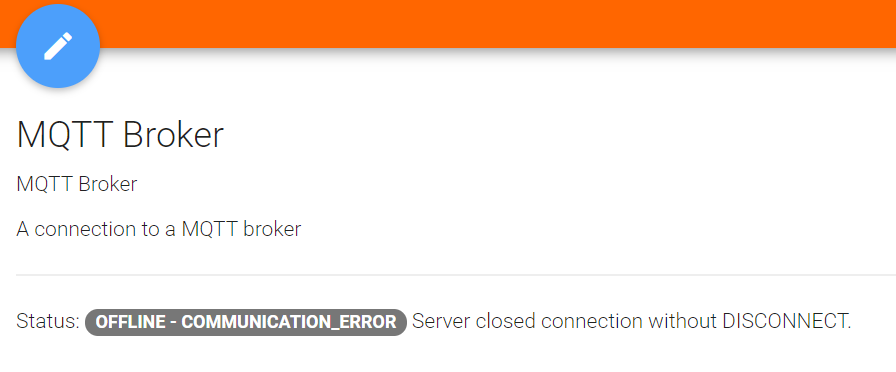

Here’s what I get when I create the broker:
09:24:23.852 [TRACE] [ng.mqtt.handler.AbstractBrokerHandler] - Subscribed org.openhab.binding.mqtt.homeassistant.internal.discovery.HomeAssistantDiscovery@2f470034 to discovery topic homeassistant/# on broker mqtt:broker:e6bcc300
09:24:23.853 [TRACE] [ng.mqtt.handler.AbstractBrokerHandler] - Subscribed org.openhab.binding.mqtt.homie.internal.discovery.Homie300Discovery@614e0cd3 to discovery topic +/+/$homie on broker mqtt:broker:e6bcc300
09:24:23.856 [INFO ] [ome.event.ThingStatusInfoChangedEvent] - 'mqtt:broker:e6bcc300' changed from UNINITIALIZED to INITIALIZING
09:24:23.860 [INFO ] [ome.event.ThingStatusInfoChangedEvent] - 'mqtt:broker:e6bcc300' changed from INITIALIZING to OFFLINE
09:24:23.864 [INFO ] [o.transport.mqtt.MqttBrokerConnection] - Starting MQTT broker connection to 'openhab' with clientid a3dfe15c-3c20-4d78-b869-391bd902dcea
09:24:23.866 [TRACE] [ng.mqtt.handler.AbstractBrokerHandler] - Subscribed org.openhab.binding.mqtt.homeassistant.internal.discovery.HomeAssistantDiscovery@2f470034 to discovery topic homeassistant/# on broker mqtt:broker:e6bcc300
09:24:23.867 [TRACE] [ng.mqtt.handler.AbstractBrokerHandler] - Subscribed org.openhab.binding.mqtt.homie.internal.discovery.Homie300Discovery@614e0cd3 to discovery topic +/+/$homie on broker mqtt:broker:e6bcc300
09:24:23.876 [INFO ] [ome.event.ThingStatusInfoChangedEvent] - 'mqtt:broker:e6bcc300' changed from OFFLINE to OFFLINE (COMMUNICATION_ERROR): Timeout
09:24:23.877 [INFO ] [ome.event.ThingStatusInfoChangedEvent] - 'mqtt:broker:e6bcc300' changed from OFFLINE (COMMUNICATION_ERROR): Timeout to OFFLINE (COMMUNICATION_ERROR): Server closed connection without DISCONNECT.

I’m configuring mqtt via Paper UI, so no mqtt.cfg (apart from the default one with all the options commented out).

I had deleted the broker from Paper UI and then recreated it, and that resulted in the logs above.
