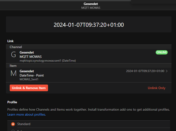

What payload is expected to “reset” the DateTime-item to NULL?
I tried:

How? It’s not clear. Did you update the Item, command the Item, send an MQTT message?
Are you just trying to update the Item or are you trying to also have a message posted or both?
The datetime Channel is only going to support a message that can be parsed into a date time so any message that gets published to that topic is going to generate an error if it’s not parsable as a date time.
I’m converting some realy biiiig JSON in Node-Red into seperate MQTT-messages
I send them to OH
as they’re warning alerts (weather, hazards, fire, high water, …) they get -hopefully!- cancelled, if the situation clears, so I’d like to reset the “sent”-DateTime to NULL
I feared that. To silence my inner monk I guess I’ll have to write a rule, if an event was cancelled, the DateTime is also nullified…
