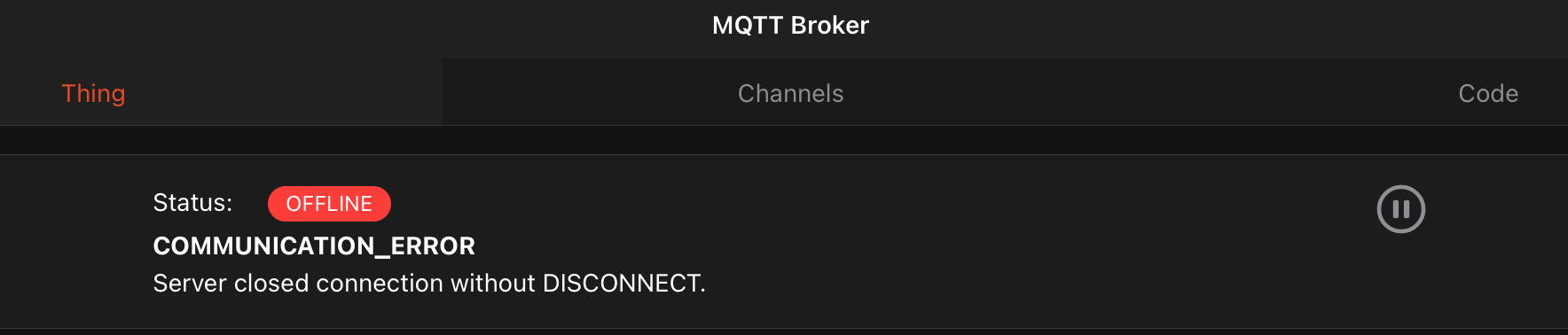

today i have seen that mq MQTT connection didn’t work anymore.
in the logs i can see this message every 60000ms.
i also tried to reinstall mqtt broker via openhabian but also this didn’t solve my problem.
22:26:57.495 [INFO ] [t.reconnect.PeriodicReconnectStrategy] - Try to restore connection to '127.0.0.1'. Next attempt in 60000ms
22:26:57.502 [INFO ] [o.transport.mqtt.MqttBrokerConnection] - Starting MQTT broker connection to '127.0.0.1' with clientid
but when i check my mqtt broker status, everything looks fine.

Post the code tab contents of your MQTT broker.
Where can I find it?
On the right side of that photo it shows “Code”. Click there then copy and paste.

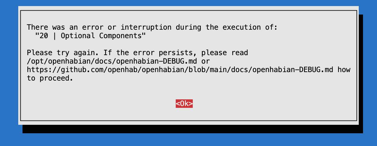

i try now to deinstall Mosquitto with sudo apt remove mosquitto but now i can’t install mqtt broker with openhabian :frowning:
i found the problem.
first, i installed mosquitto with sudo apt-get install mosquittoand then i could reinstall MQTT broker via openhabian.
