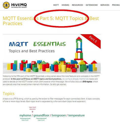

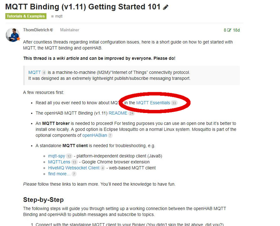

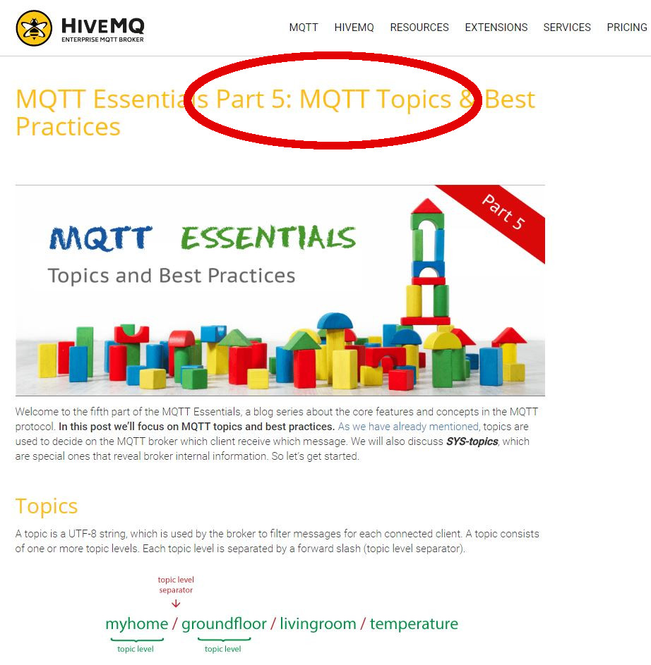

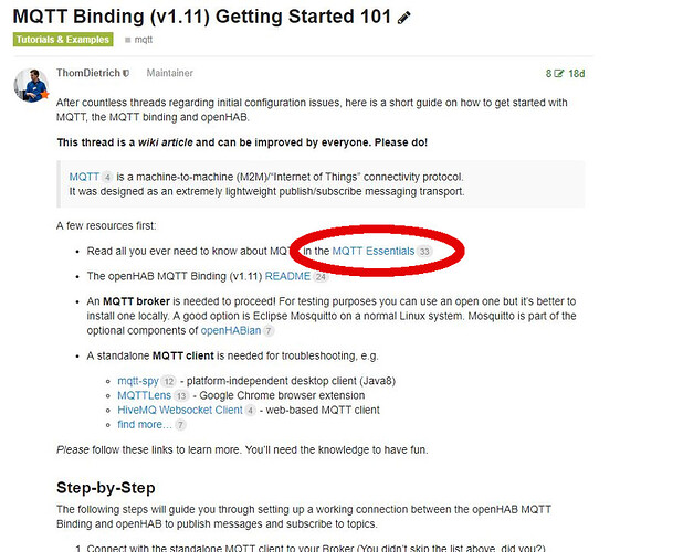

Did you even read my link above???
Yes, that’s how I found out about MQTTlens, which I prefer, before that I was using MQTTfx.
However, since your question seems rhetorical, I just read it again, it doesn’t mention anything about topic prerequisites.
No idea. But I have just SSH’d into the server and it says 2.1.0 Release build. Whatever that means. The only reason I think it’s the latest version is because I did an apt-upgrade thingy a few days ago. All this Raspeberry Pi tomfoolery doesn’t exactly speak to my skill set.
Please excuse my ignorance.
Many apologies, when you asked ‘Did you even read the link above?’, I did not presume you actually meant ‘Did you even read the link above, and follow all the links on that page, and follow all the links on the pages the links had within those pages?’ As such I would like to change my answer.
No, I did not even read the link above.
What I actually did was read only the first link (above), and follow the step-by-step.
Having read section 5, as suggested, it is still ambiguous as to whether subscribed topics have to start with a particular prefix, since the only topic I have is ‘flat/test’ then ‘flat’ could be considered my top-level topic, and as such satisfies any future topics where ‘flat’ is also the top level topic, although there is a whole paragraph that states multiple topics with differing top level topics can be maintained on the same broker.
