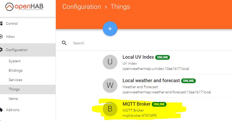

not sure if this was resolved but I ran into the same issue and finally got it fixed by editing the /etc/mosquitto/mosquitto.conf file and adding the following line: listener 1883
more information can be found in the link below
https://gist.github.com/mirhec/27e8df1b2ff52196fabb0f9ea5f4313f

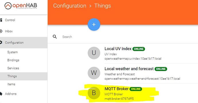

Now my MQTT Broker Thing shows Online
