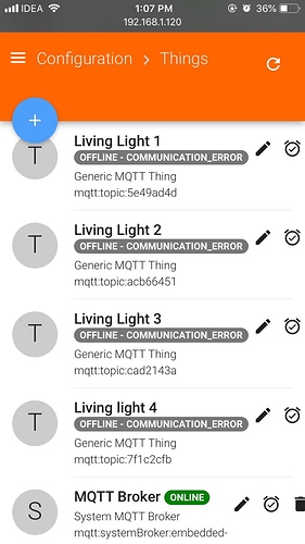

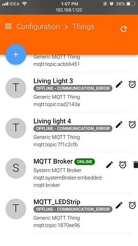

It all works fine but today I tried to control my lights and LED strip nothing was working for me then I checked in Paper UI can Could see my Devices were Offline due to some communication error.
In Paper UI I cloud see all devices were offline other then MQTT Broker. but when i checked log file could see broker was also offline which was not reflecting in paper UI:
When I checked Openhab Log file I could see below Error:
