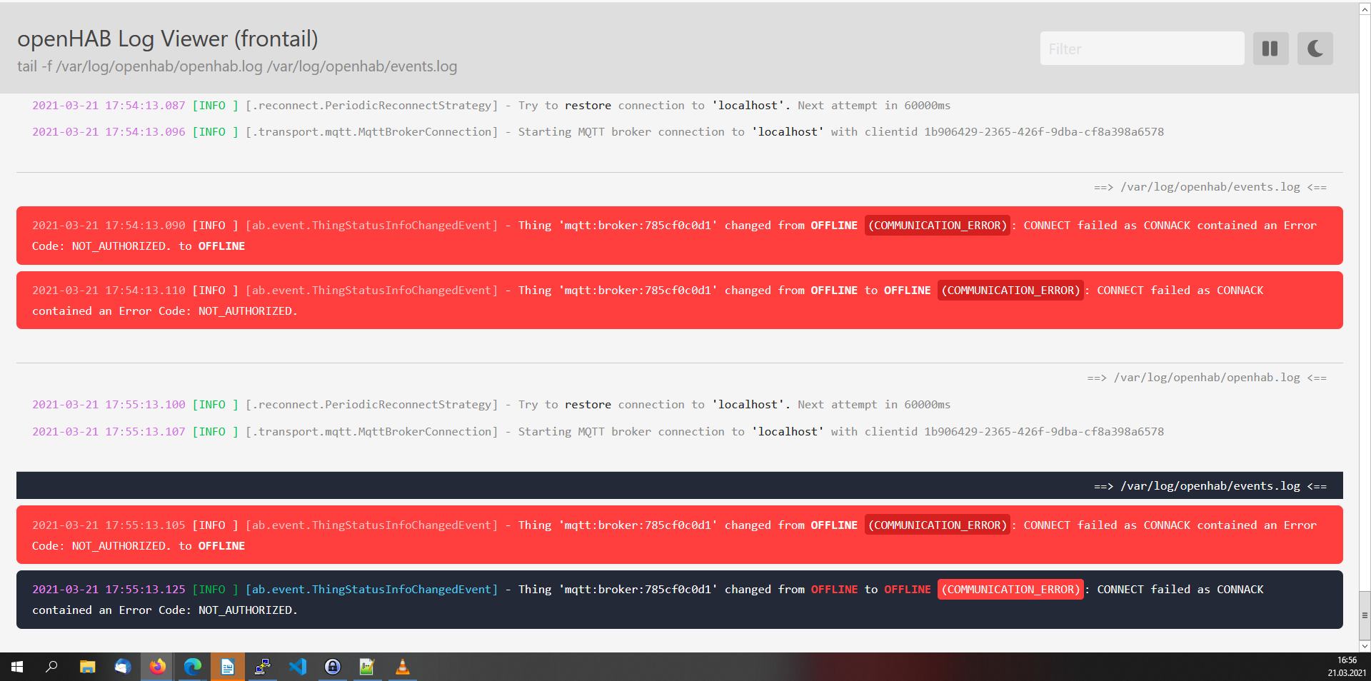

I have a problem with MQTT.
I had the same Problem already with obenhab 2 and now with openHAB 3.
I installed openHAB 3 on my Raspberry PI 4 an added an Broker.
all worked fine but after a time might a restart the broker wont work.
COMMUNICATION_ERROR
CONNECT failed as CONNACK contained an Error Code: NOT_AUTHORIZED.
I would be very happy if someone could help me.
Thank you
