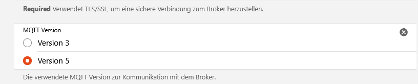

Make sure you have set the correct MQTT version in your Thing definition:
sudo mosquitto -h
mosquitto version 2.0.11
You need mosquitto > version 1.6 to enable MQTT 5.
I used v3 since ever, my broker runs in another docker, is the current mosquitto 2.0.22, which provides both v3 and v5.
I changed my broker configuration to v5, but that did change nothing. Still no new information on that specific device/thing - but other devices work as intended (I’ve got 121 devices/information coming in through MQTT with about 2 to 20 payloads each.)
