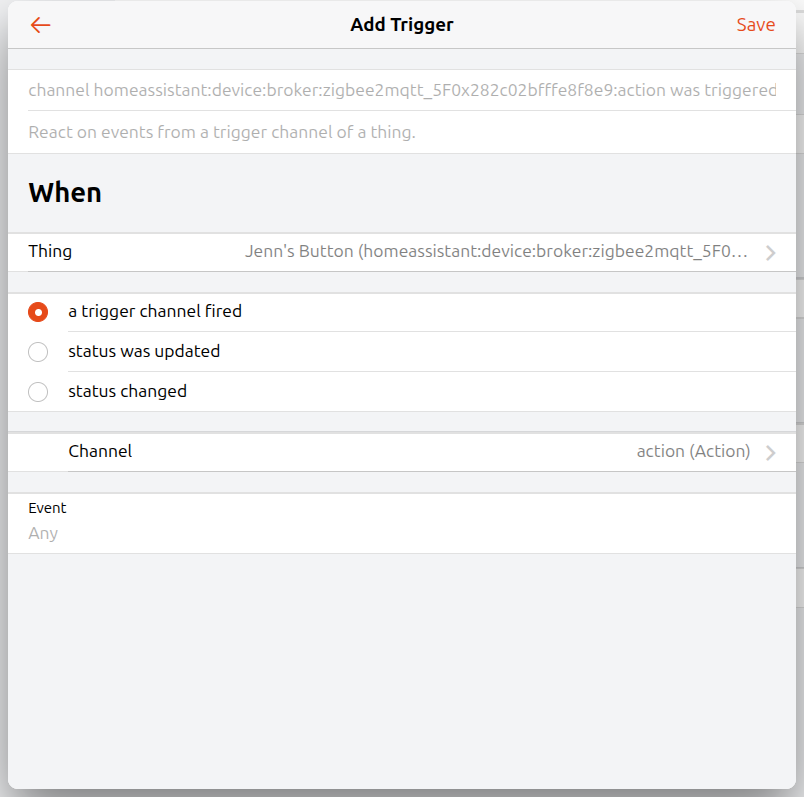

I think I misunderstood the original problem. I thought the Channels didn’t exist on the Thing. Now I’m wondering if the problem is you can’t link the Channels to an Item, and that is by design and not specific to the Home Assistant binding.
Actions turn into Event Channels which cannot be linked to an Item (without using the proper Profile). You would use a Channel Trigger on your rule, not an Item Changed trigger.
I can’t remember when this changed but IIRC it was mentioned in the breaking changes and it changed long before the Home Assistant binding was split off from the main MQTT binding.
I thought the problem was the Channel simply didn’t exist. But if you see the Channel on your Thing and the problem is you cannot link it to an Item, that’s by design. Event Channels represent ephemerial happenings without a state (e.g. a button was pressed). Because there is no state, it doesn’t make sense to link them to an Item whose entire purpose is to represent state.
These Channels trigger rules directly without going through an Item.
In a file based JS rule you’d use triggers.ChannelEventTrigger('astro:sun:local:rise#event', 'START');. In the UI you would use Thing Event and you can select the Thing and then select the Channel.
In your rule, you can retireve what event it was (i.e. the “string”) usign event.receivedEvent.
That’s the proper way to handle Event Channels. However, alternatively you can link them to an Item but you have to use the Trigger Event String Profile to convert the Event to a state update so the Item can see it.

It wouldn’t be a parameter. It would be a separate Channel. I assume you mean you checked “Show Advanced” on the Channels tab here?
Note, because these Channels cannot be linked to an Item without the profile, those links that already exist will show as orphans. That does not necessarily mean the Channel doesn’t exist.

Take a look at the log. You don’t need an item.
To elaborate on @Tschetan’s answer, Things support a special type of Channel called an “Event Channel”. These Channels *cannot be linked to an Item. That’s why they don’t show up. They are not intended to be linked to an Item.
As I said above and @Tschetan quoted, these Channels represent ephmeral events like a button press. These Channels are used to trigger Rules directly instead of going through an Item.
