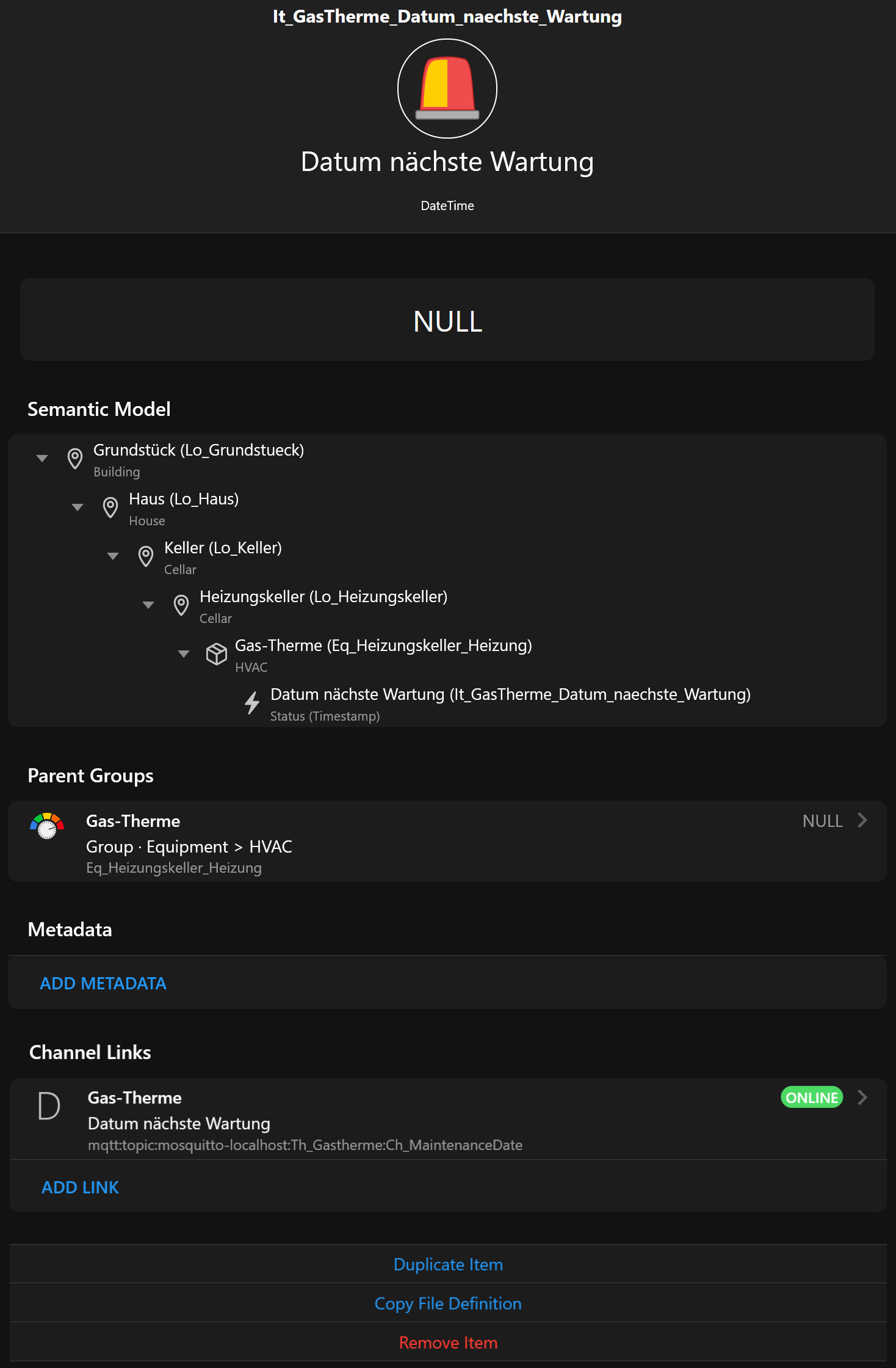

You’ve added the transformation only to the way the Item is shown on the UI.
The Item has not been updated. It’s state is NULL. It will not receive a state until an MQTT message is received by OH.
When you tried to look at the Item in the UI, it invoked the transformation and that function doesn’t handle NULL. It doesn’t need to handle NULL because if you use it on the Channel it will never see NULL.

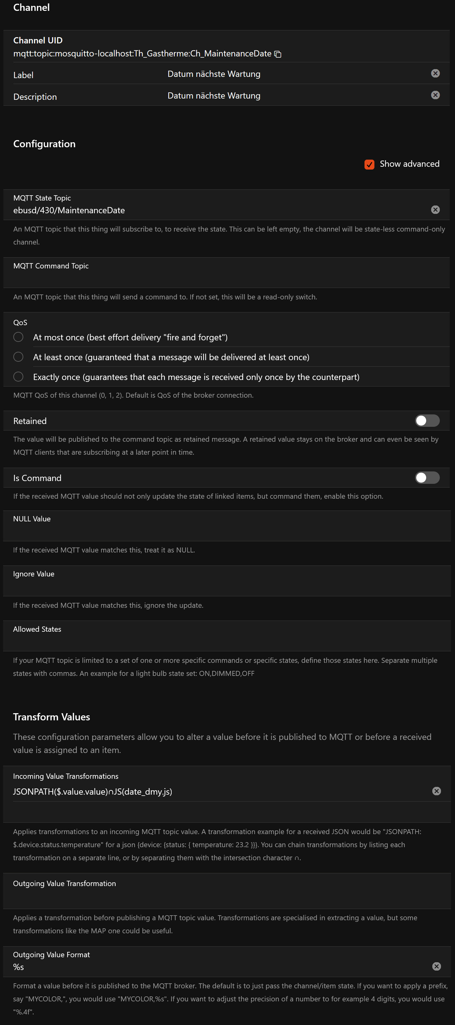

I replaced the channel with one of type DateTime and used the incoming value transformation
JSONPATH:$.value.value∩JS(date_dmy.js):%s

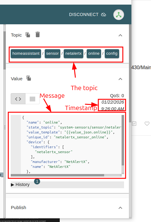

Note that MQTT Explorer shows past messages. Double check the timestamp on the message to see when it was sent. That will tell you if ti was sent after saving the changes to the OH Thing.
If the message was not retained and the message was sent before you saved, nothing will happen.

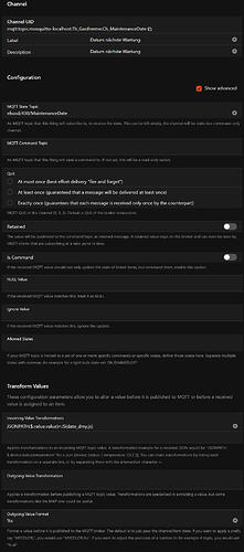

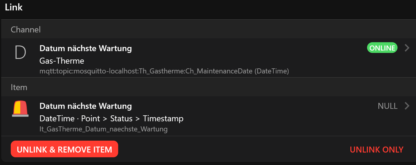

This is the channel definition:

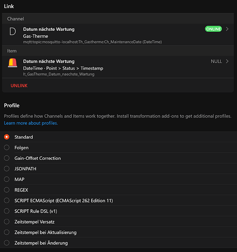

and this is the item:

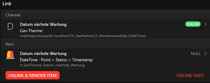

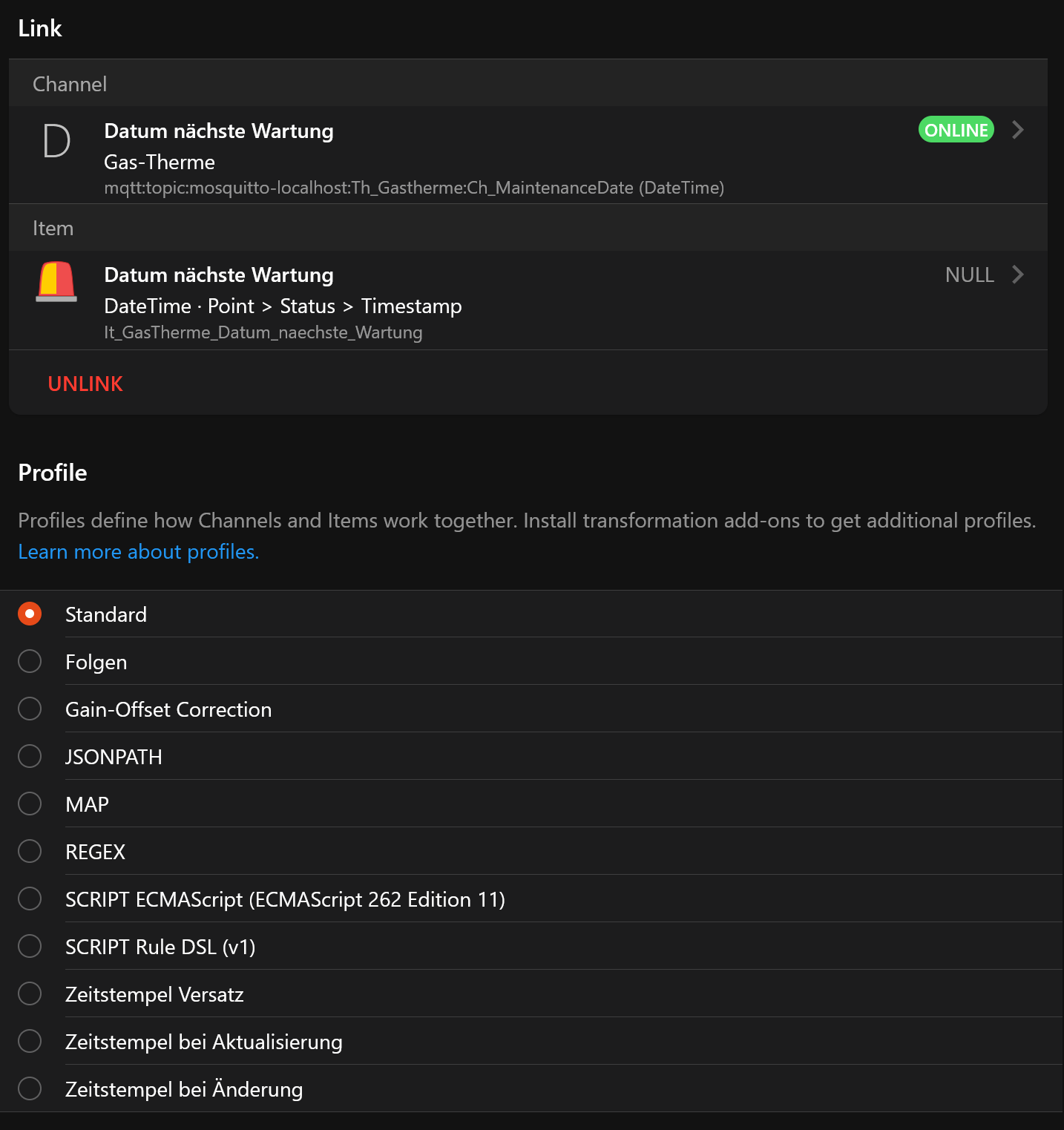

and here is the link:
There will be errors in openhab.log if this is the case. Transformations do not fail with an error silently.
There is pretty much nothing that can go wrong here unless you’ve applied a profile. All the link consists of is the name and the Channel ID. there isn’t something more that can break. But you can search for orphaned links in the karaf console. If there is a problem there, it will show up as orphaned.
The Item wouldn’t show up at all if there is a problem there.
