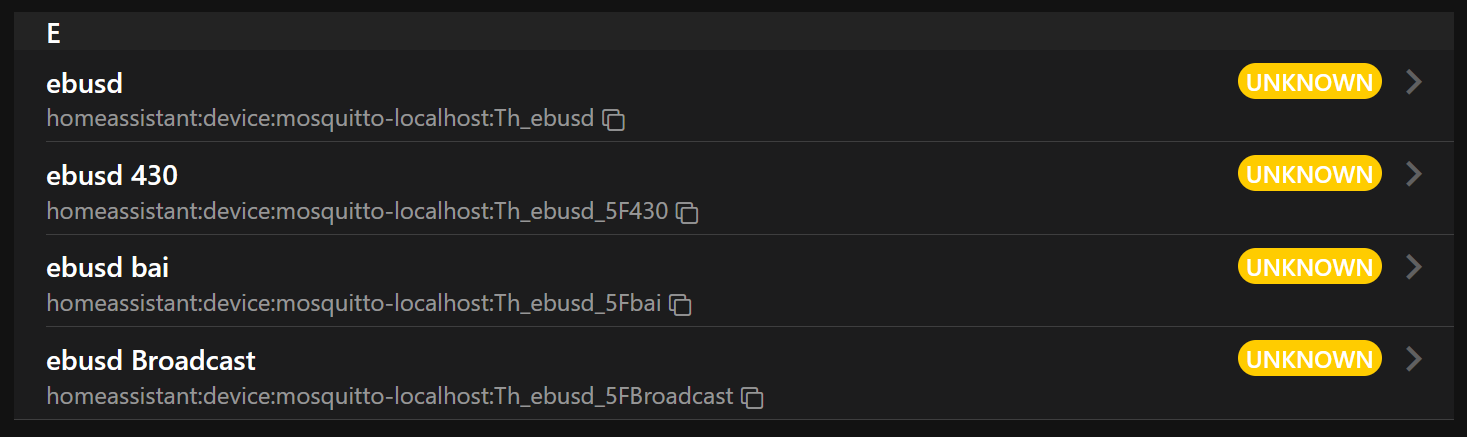

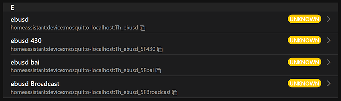

I used the button “add as thing” and changed the name (not the label) in the following dialog.
This is the view of the created things:

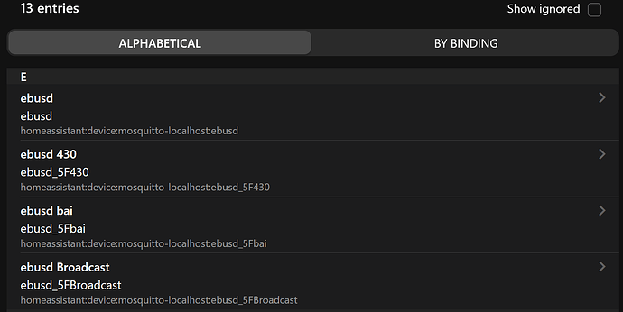

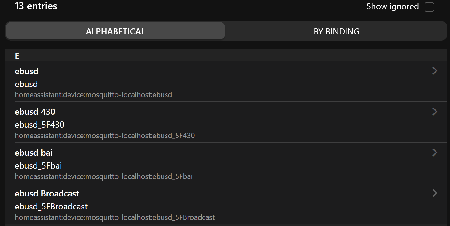

and this is the inbox after thing creation:
You mean the ID? OK, that explains why the Things are still in the inbox. I wish it were smarter about this but it uses the ID to determine if the Thing has been created or not. If you changed the ID that means the inbox still thinks the one in the inbox is a new Thing. You can select them and ignore them.
