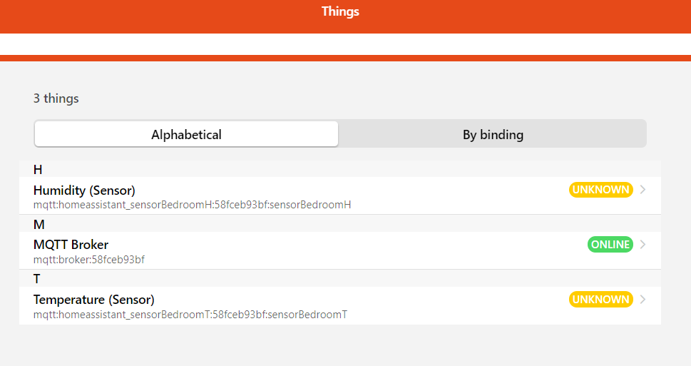

as expected this results in two devices popping up in my inbox:
screenshot removed
then I add both as things.
then I post a measurement to the state topic (as per the HA example)
topic homeassistant/sensor/sensorBedroom/state
message { "temperature": 23.20, "humidity": 43.70 }
at this stage I was expecting the values to show up automagically in OH3,
as individual channels under the thing(s). But the channels remain unpopulated.
screenshot removed
What am I missing? How to get values populated automatically in the channels?
(or ideally as multiple channels under the ‘one thing’ , but baby steps first :wink: )
