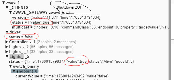

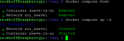

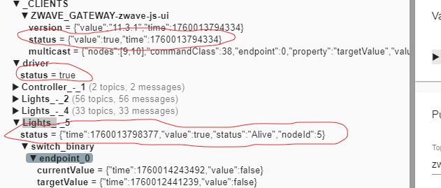

Not a solution, but a data point that this is not an issue with ZUI (Zwave-js-UI).
Test: Activated on HA Thing. Config from MQTT. One difference is that there are three availability options.
  "payload_off": false,
  "payload_on": true,
  "value_template": "{{ value_json.value }}",
  "command_topic": "zwave1/Lights_-_5/switch_binary/endpoint_0/targetValue/set",
  "state_topic": "zwave1/Lights_-_5/switch_binary/endpoint_0/currentValue",
  "availability": [
      "payload_available": "true",
      "payload_not_available": "false",
      "topic": "zwave1/Lights_-_5/status",
      "value_template": "{{'true' if value_json.value else 'false'}}"

In MQTT Explorer online
Then I shutdown the application
When Shutdown the Thing was offline in OH (Not unknown)
offline2025-10-09 090526
Interestingly only the driver was false. The other availability topics were retained from before the shutdown (note the timestamps were the same).
And was back online after the restart
After 2025-10-09 094531
The question still remains what is triggering the OH binding to purge the channel in traefik rather than simply mark offline (it has to related to the LWT as that is the only availability parameter) and what can be done in OH (or in the app sending the config), however, it is not a universal problem IMO (from this test).
