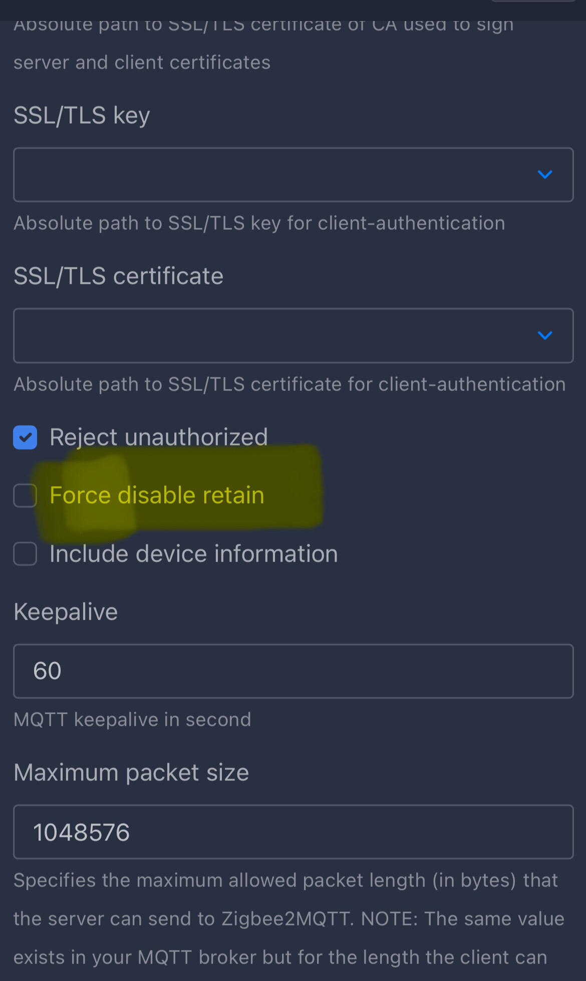

I looked in zigbee2mqtt and only found this “disable force retain” in mqtt, is this what you meant?

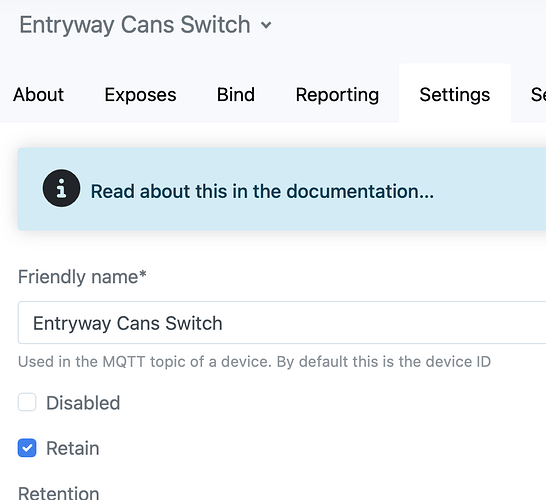

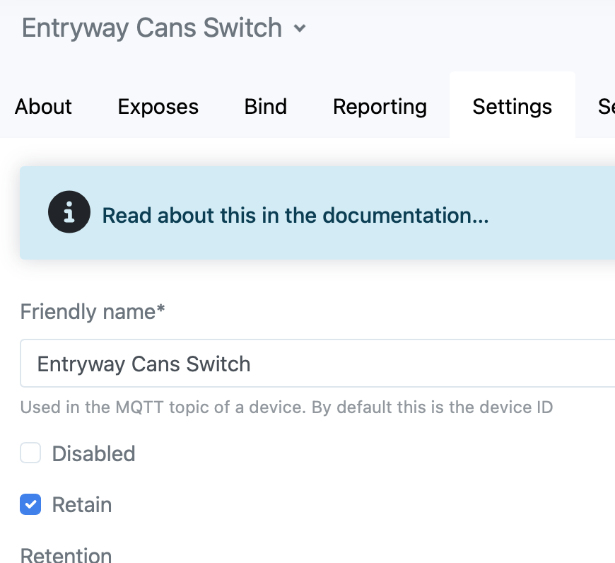

No, I’m referring to the device settings:
If you edit configuration.yaml directly, you can set it for all devices at once, with the device_options top level key:
device_options:
  qos: 1
  retain: true
  optimistic: true
