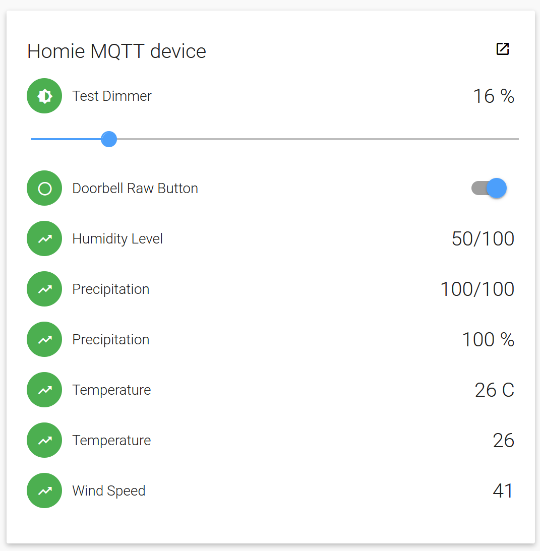

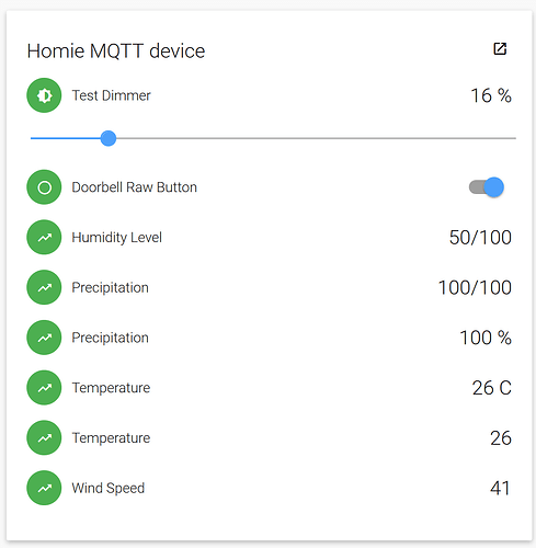

Howdy! I have a simple question, for once. :grin:
My MQTT Homie device exposes a property named “dimmer”. $settable = true, $retained = true, $datatype = integer, $format = 0:100
I have the following item defined:
Dimmer DimmerTest              "Test Dimmer [%d %%]"                    <slider>	(FF_Homie)  { channel = "mqtt:homie300:ab60b3fb:nodeid1#dimmer" }
I see the slider in BasicUI. I can adjust it. If I set it to the middle, it reads 50 % as expected.
The log says the following, exactly as expected:
2019-07-02 23:37:57.439 [ome.event.ItemCommandEvent] - Item 'DimmerTest' received command 50
2019-07-02 23:37:57.476 [nt.ItemStatePredictedEvent] - DimmerTest predicted to become 50
2019-07-02 23:37:57.518 [vent.ItemStateChangedEvent] - DimmerTest changed from 88 to 50

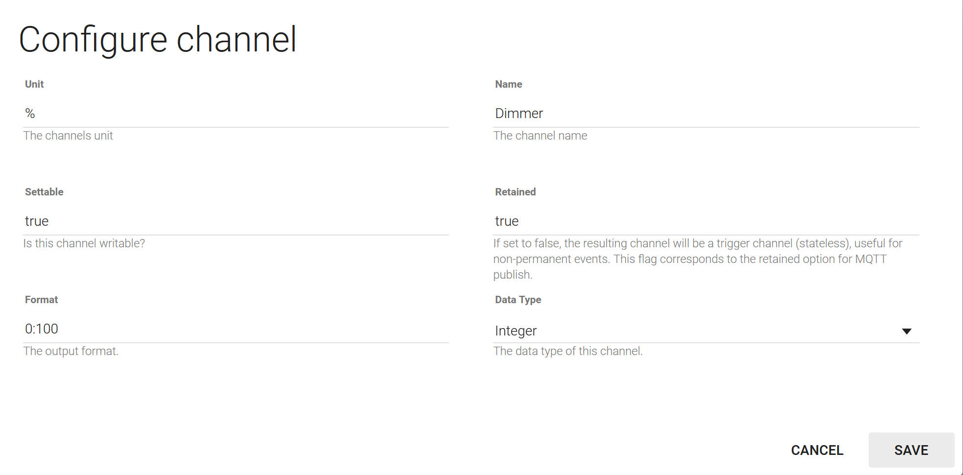

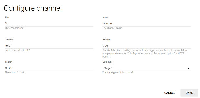

Look at the channel in PaperUI for the minimum / maximum settings?
I checked, here’s what I saw:
Looks okay to me? I tried to follow this spec.

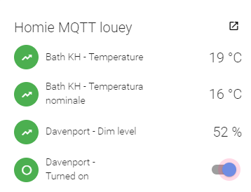

It’s a bit weird but this appears to be working for me as 0-100 integer messages from HA in set
Not sure about UI presentation of a light though.
Whoa! Why is it working for you and not for me? :slight_smile:
Are you using Paper UI? I was using Basic UI. Will try Paper UI now.
What is the actual MQTT payload, for completeness? There’s no inherent reason a 50 percentage cannot be transmitted as 0.50 and unpacked at either end.
The issue is really that homie3 defines it’s nodes and their value ranges - if the other controller discovers these nodes via homie it should really honour their ranges. homie3 does not define how brightness levels are represented eg 0-255 0-100 0.0 -1.0 - if you have to build conversion back from a reported value it all gets too complex and is not clear e.g is a set of 80 in the 0-100 or 0-255 range
The set payload (command) is 52 and the dim level payload (actual) is also 52

Here’s what it looks like for me in Paper UI:
It gave me a proper slider! But it still sets 0.16000000.
